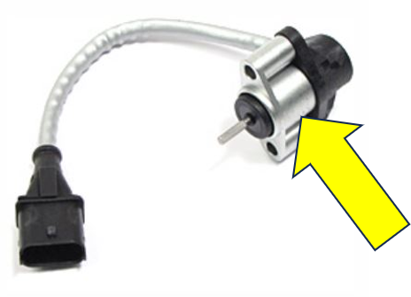

Reluctor ring is on front side of flywheel (yes, mixed up flex plate terminology). Thanks for the photo. Where the CKP sensor stinger fits between the pins. Not easy to access, maybe peek up in there via inspection plate, or mirror through the CKP sensor hole. If the CKP is a Hall Effect sensor, signal quality can degrade at low speed, so potentially an issue, even though a long shot. This is where a high quality sensor can make a difference (e.g. NGK), and make sure it is installed with the correct spacer for correct insertion depth.

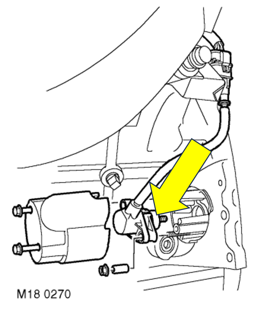

"and make sure it is installed with the correct spacer for correct insertion depth" This has been rattling around in the back of my head ever since I came across a post on this forum where a member claimed his multiple misfire issue was solved with a new CrankPS... Mine is a genuine LR part ($$$) that I bought new 2 years ago - with probably 12 months of accumulated run time. I did remove it a couple of weeks ago to ensure I installed it correctly and that there were no issues with the connector. The CPK comes with a sleeve/spacer and I believe it can only go in one way. I assembled as per the diagram and picture below. How can I tell if the stinger is deep enough into the reluctor groove in the flywheel - or not? Come to think of it, this is a primary difference between my old build and new - the block. The builder supplied me with a replacement block. Everything related to the CPK fitting in the replacement block seemed fine, but I am not sure about stinger depth - other than I know it is not too long and making contact with the bottom of the groove because I did not see any damage when I pulled it out.

CKP sensor spacers are different for manual vs automatic transmissions, according to interweb, manual are nearly 1/2 inch skinnier than autos. Older Rovers used skinny shims to adjust for a tiny 1 mm or 1.5 mm gap (between stinger and flywheel). Super hard to measure there, so they must have felt it just touch then back out one shim.
The sensor mounting disc (that fits to the block) is removeable on D1s, not sure about D2s. Maybe check the mountings are all seated completely in the new block, and right down the middle? We're talking tiny dimensions here, right on the borderline. Also some sensors signal quality will degrade more than others at low speed, even within a batch, and be effected more by dimensional mounting differences. So might make a difference with a different sensor. Did you reset adaptive values of the ECM? Have you measured alternator voltage at idle? Low voltage can cause weird codes too.
