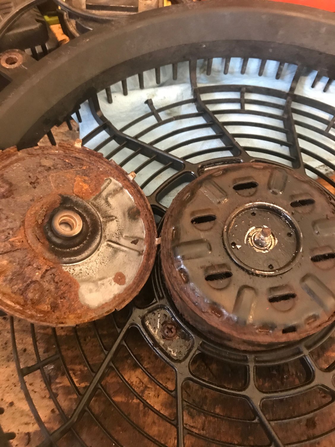

You can physically disassemble the fan and inspect the bearings and brushes/armerature. The bearing on the back plate can be removed and flipped around(usually ovalled and brass material).

That’s now the plan. I was gonna jump the relay like suggested but the fan is completely seized and jumping it will definitely just blow the fuse.

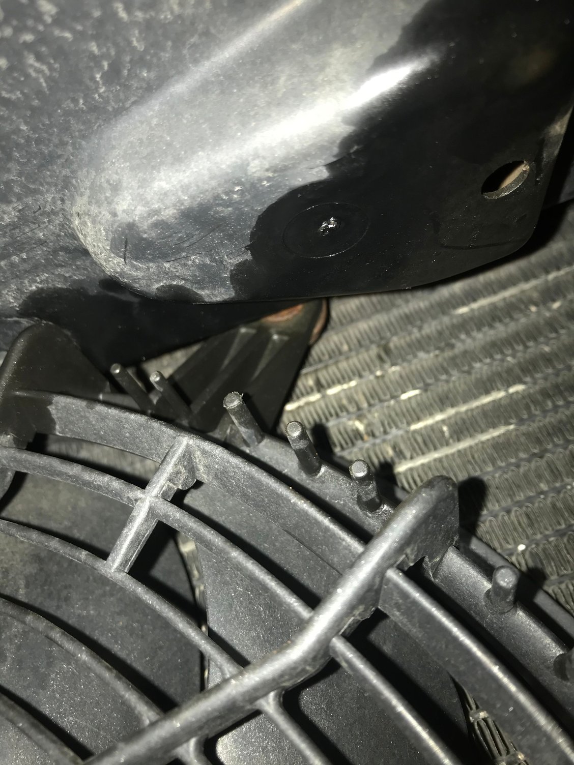

So I’m gonna take the fan out and replace it with one from the junk yard. Attached a picture of the fan for reference. I have no idea how I am going to get the top bolt out of the fan with the hood latch in the way shown in the second
picture. I am open to any suggestions.

8mm ratcheting box end works a treat.

It’s actually a 10mm now that I think about it but no, not familiar with that code.

nope you were right initially - 8mm

Got the motor ripped out and it’s completely seized and won’t spin at all even with some force. Now to order a new one. Anybody got the part number of the motor itself ?

Hey guys just wanted to post an update. Replaced the fan with a cheap amazon won that pushed roughly the same amount of air and reset all engine codes. Everything went smooth and the fan turned on under the specific conditions and when jumping the relay.
I will post an update in a couple days to see if P1481 comes back or if that solved it.
