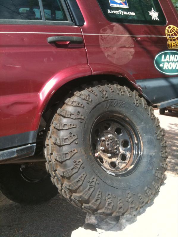

saw you posted this over on Pirate, so I figured I come over and take a look...
you are 100% wrong in this statement:
"The only thing I have to say after all of this is any one running 33inch or larger even with a lift will have to modify their fenders in some way, lifted or not once running under extreme articulation. ONCE the tires fit just imagine the true Articulation you can have. Lifted is nothing more than a preference!! "
You can fit up to a 35" tire on a D2 WITHOUT any trimming. With a 2" lift, you can run up to a 32" without any trimming (see attached). With a 3" lift you can up to a 34" tire. I understand your point about keeping it low, but a 2" lift doesn't effect the COG to the point where the truck becomes tippy in anyway. Even a bodylift from Justin at Lucky8 would have served your purpose better.
I agree with the statement that you don't have to lift a truck to go off-road. I have 2 LR's , a D1, which is stock and D2 that is built up with Toyota FZJ80 axles and 37" IROK's, my ride height is the same as D2 with a 3" lift and I didn't have to trim anything. I take both trucks offroad, on the same trails and have zero issues with either. They both are very capable and I even still have the swaybar's attached on the D1. So my point is that your statement about having to trim to fit a larger tire on a D2, even with a lift, is 100% WRONG...
