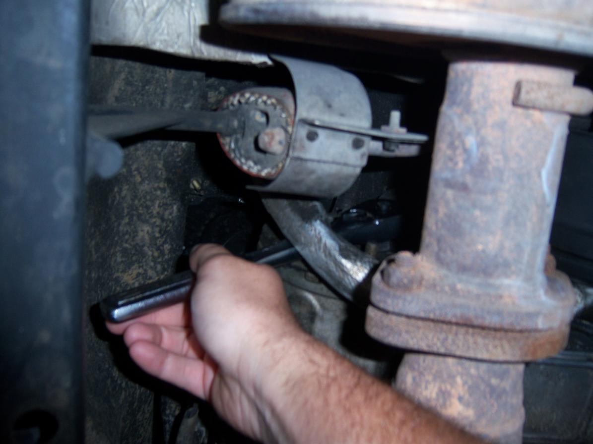

I just use a 1/2" ratchet, no extension, no swivel. I go up over the exhaust and put the ratchet in between the parking brake cable and the T-case. It works best and is really easy once you do it the first time and figure it out.
Checking Transfer Case Oil-100_2456.jpgChecking Transfer Case Oil-100_2458.jpg
