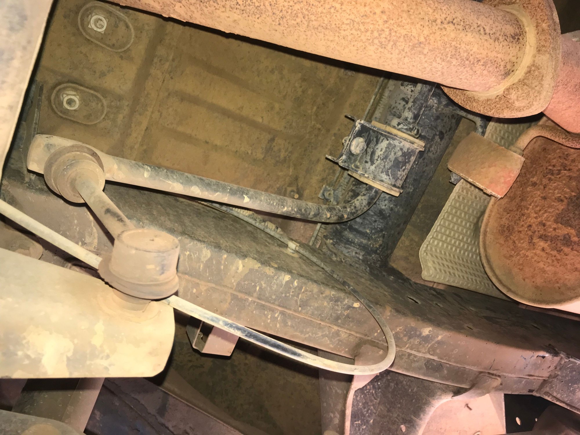

Originally Posted by TaylorCadence
hmm not sure what this is but I’ll crawl under and take a look at what youre referring too. any specific name for the bar?
Rear torsion bar, but I don't know if that's what LR calls it or not.
i think we’re all talking about the same thing, these right:

By the looks of that boot on the lower mount...it's probably wornout inside.
​​​​​​​ Brian.
Old Jul 27, 2018 | 04:47 PM
Was thinking the same thing Brian
Popped in new poly bushes for Watts and outer arms but still feeling that clunk in my seat when going over tough terrain. Had my brother rock the truck back a forth while I check the Linkage and everything seems tight with barley any movement. Looks like they’re just squishing from the movement. Any suggestions?
Do you have ACE? I replaced the bushing on the rear actuator and no more clunking. The bushing is easy to overlook.
