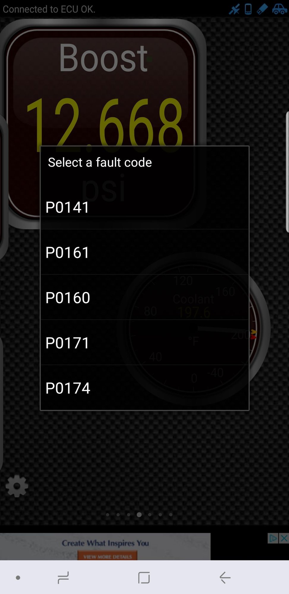

So these are my current issues. I love my discovery, but these codes are driving me insane. I've been working on these awhile. Here's what I've done:
New Bosch O2 sensors
New MAF
New Bosch Platinum Plugs
Bought new oil separator but haven't installed it yet.
When I bought it the CAT's had already been cut out. I put a plug fouler on bank 2 sensor 2 but maybe I need something taller, that takes the O2 out of the stream more. Any help appreciated.

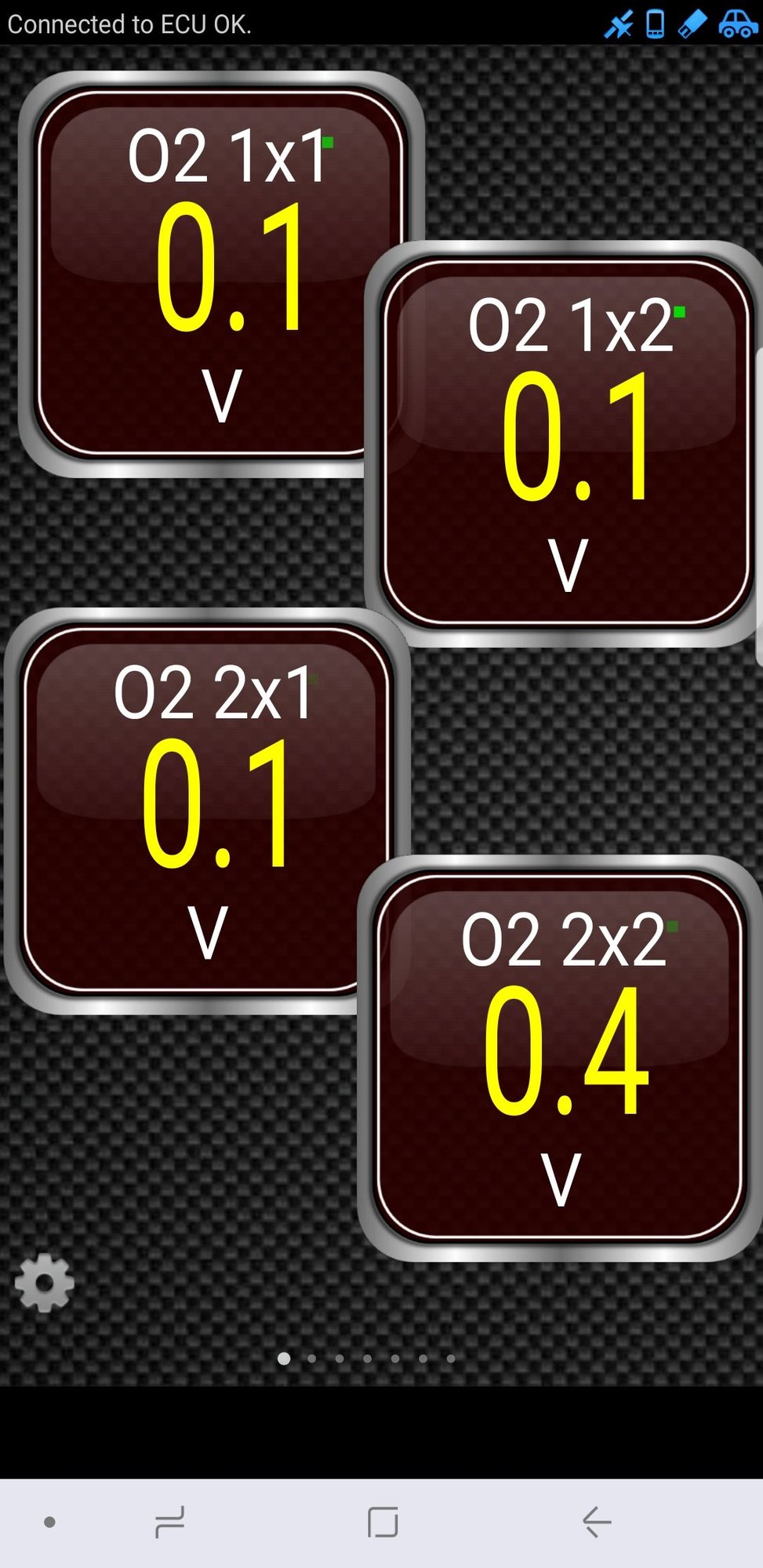

After putting in the old MAF to see if that the problem, I drove it around for a bit and let it get nice and warm. Then parked it and these are the readings I got.

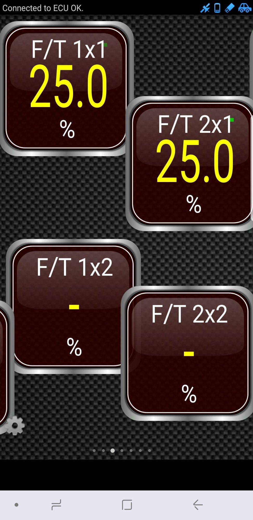

Also, I noticed that my fuel trims were weird. Like I said, I don't have cats's so my rear fuel trims was 0%. But my front bank 2 stayed at 25% and my bank 1 was bouncing between 25% and -100.8% .

We need to see a graph of your oxygen sensor voltages, you need to use the graph function instead of the display function. Record a video and put it on youtube with a link to the video. Your oxygen sensor voltages should be cycling between 1 volt and zero volts - the display that you posted shows only .1 volts. If it only ever reads that you likely have bad oxygen sensors - they read close to zero when they go bad. the sensor shoudl read 1 volt on cold startup, then start cycling after a few minutes. zero volts or .1 volts indicates a full lean condition, that would cause your fuel trims to go full rich.

my guess is the low fuel economy is because both oxygen sensors are dead and thereby reading full lean, causing that ECU to go full Rich to try and compensate.
