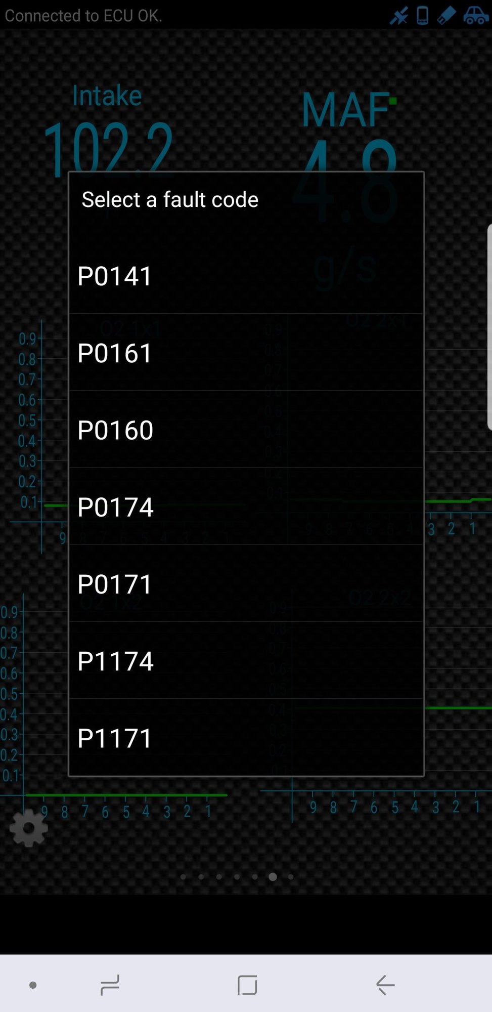

So I drove about 50 miles today and here are the logged and pending codes that I had at the end of my trip. I am also working on getting the videos uploaded. I have extremely slow internet so hopefully they will upload before I give up on this truck. LOL
Here are the logged codes
Here are the 2 pending codes

We need to see a graph of your oxygen sensor voltages, you need to use the graph function instead of the display function. Record a video and put it on youtube with a link to the video. Your oxygen sensor voltages should be cycling between 1 volt and zero volts - the display that you posted shows only .1 volts. If it only ever reads that you likely have bad oxygen sensors - they read close to zero when they go bad. the sensor shoudl read 1 volt on cold startup, then start cycling after a few minutes. zero volts or .1 volts indicates a full lean condition, that would cause your fuel trims to go full rich.
Here are the links to the videos. They don't really adjust much.
https://youtu.be/LwF6SopBnxg
https://youtu.be/JNp0oQ7tXGo
Old Nov 21, 2018 | 09:01 PM
Extinct's Avatar
Posts: 5,264
Likes: 1,809
From: Lynchburg VA
OK, your o2 sensors are reading full lean, causing your ecu to go full rich. There a few possible reasons:
  1. The sensors are dead. You can test this by monitoring during cold start up. The ecu goes full rich on cold start up so the sensors should read almost 1 volt initially if they are working. If they don't, you have bad sensors.
  2. You have a massive vacuum leak. If this were the case (and the sensors worked) you would likely see the sensors voltage go up when throttle opening exceeds about 60% - pulling a grade fore example.
