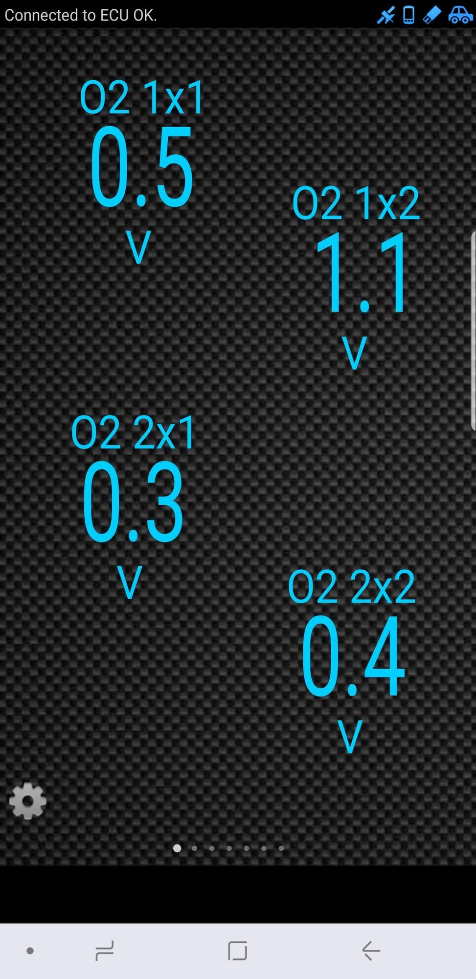

Well.... Happy Thanksgiving guys! Looks like I have a big vacuum leak. Here we're my OWN values at startup. Now, would this have anything to do with the SAI hose problem I'm having in a post above?

What do they look like at sustained 80% throttle. Do a zero to 70 run warmed up. Vacuum leaks are rarely large enough to affect WOT
The numbers drop to stay about around .1 except 2/2 and it's at .4. the 3 bounce around a little but stay pretty low
Sounds like the o2's are shot. - read below.
