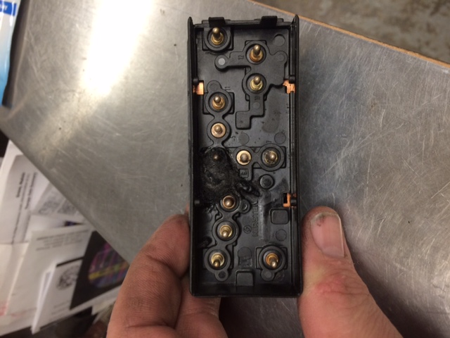

Since the purchase, I replaced all of the brake pads and front rotors. The front brake needed replaced but the back were still really good. Changed out the front, center, and rear diff lubes and had the brake system and tranny fluids flushed. The LH seat switch was fried and replaced it with one from ebay..$23 easy fix. Replaced a burnt out dash bulb and drained 1/2" of water out of the LH head light assembly. Not sure how that got in there. Waiting for a RH window regulator, the current one is trashed. Everything else appears to be working. Have had a P0420 code pop up twice now if I get on throttle hard on bank one (RH side I believe) I suspect the cats may need replaced. It does have a slight ticking once it's warmed up. Sounds like a common problem. Will have to investigate in the future where it's comming from. Attached is a pic of the seat switch. It was definitely chard!
