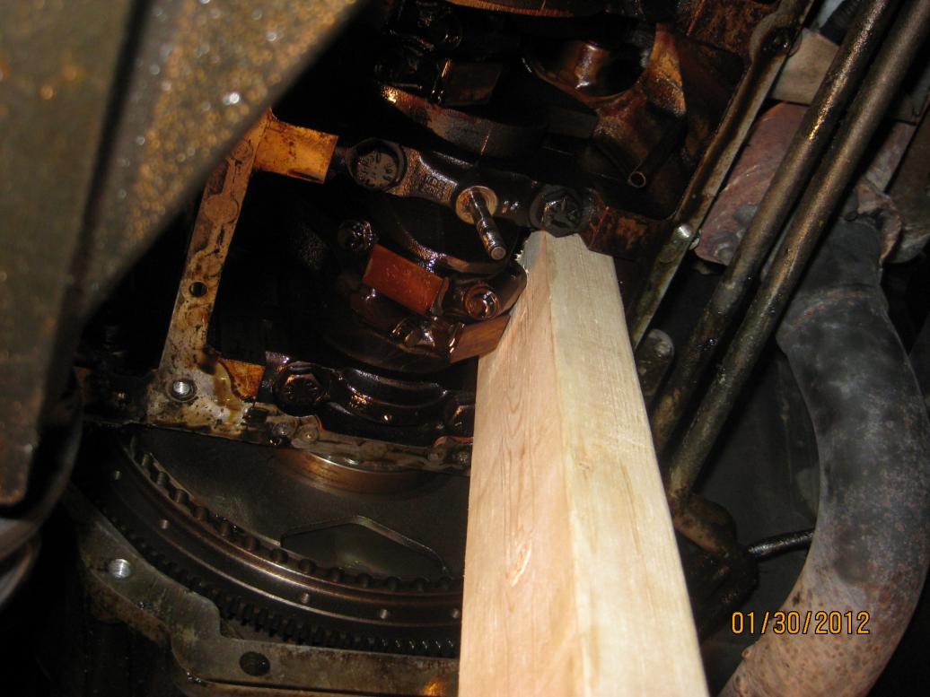

And with the oil sump / oil pan off, it allows you another method to release the harmonic balancer (big honkin' pulley at the bottom). Pix shows one way, you can also use a breaker bar wedged against the ground and bump the starter (turn key for a moment).

make sure you breake the bolt on the harmonic pully BEFORE you take the belt offf
