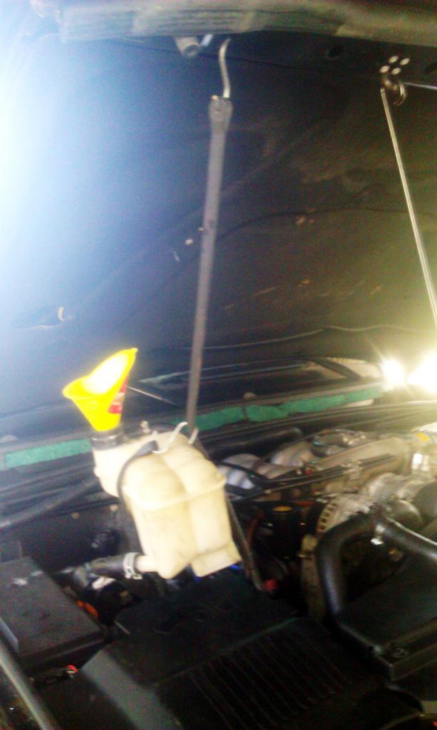

You can remove the coolant reservoir quite easily. Pull up on the rear, it will be firm, but the tank pulls up off the two round plastic cylinder shaped plastic pieces side by side. I basically works like a spring clamp on the outside of the two plastic pieces that are really connected in the middle to make them on piece. The reservoir has plastic rounded arms (like a clamp) on the bottom rear that snap over the double cylinder looking piece. Then pull it up and to the rear to pull the bottom front flat piece of plastic out of the slot in the metal under it. You will have to wiggle it a bit, but it will come out. I usually do this and wrap a long bungie cord around it and hook it, and put the other end of the bungie cord in a hole in the frame of the bottom front of the hood to suspend it in the air. It helps to keep the air out and minimize the need for burping the cooling system. While up in the air, you can see pretty much all around and under the coolant reservoir.
Not the best picture with the sun in the background, but you get the idea.
Tony, I get the hanging part..... But what do you do with the liquid inside the tank when you disconnect the two hoses? Just let it drip out?
Should I not worry about air being trapped inside the hoses once I install the new tank? Also since I'm at this, is it better to lengthen the rubber hose that runs to the fragile nipple so that it won't be as rigid as before?
