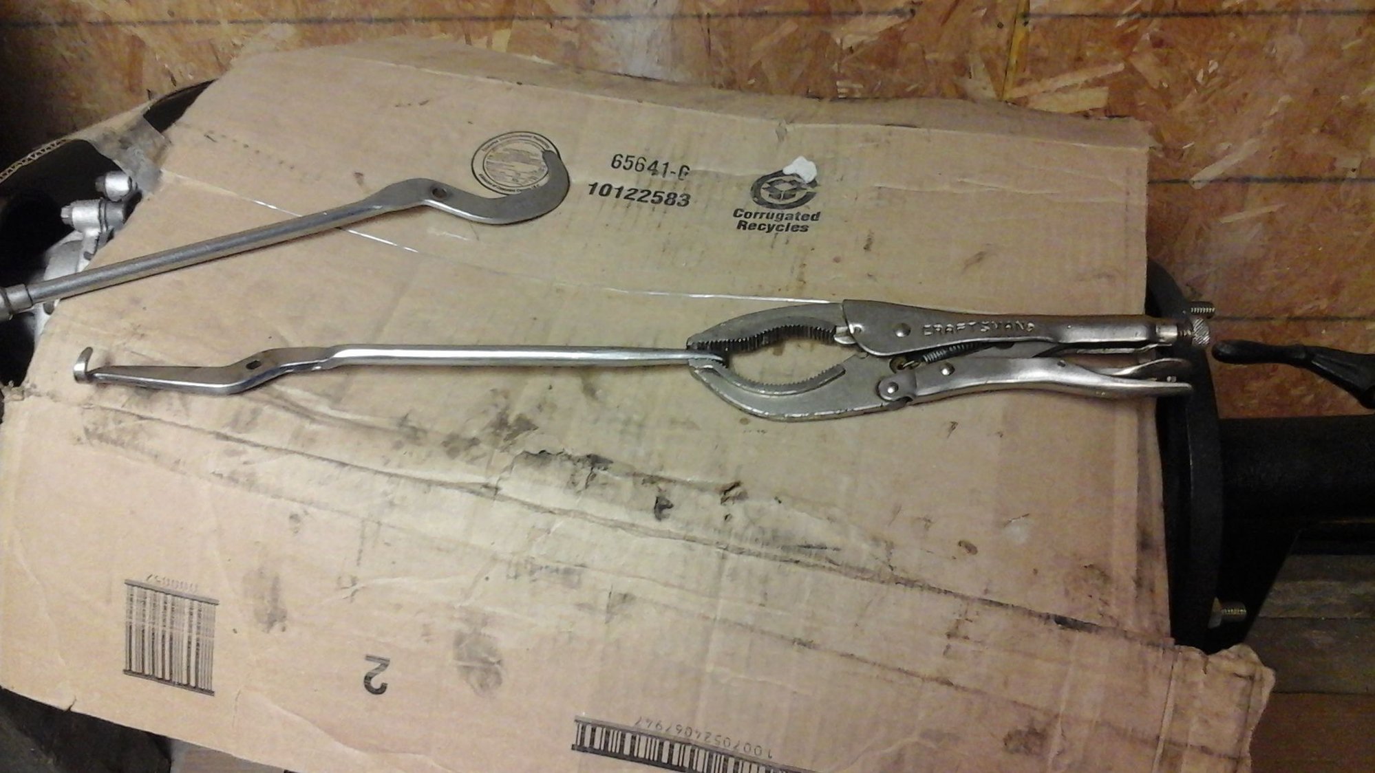

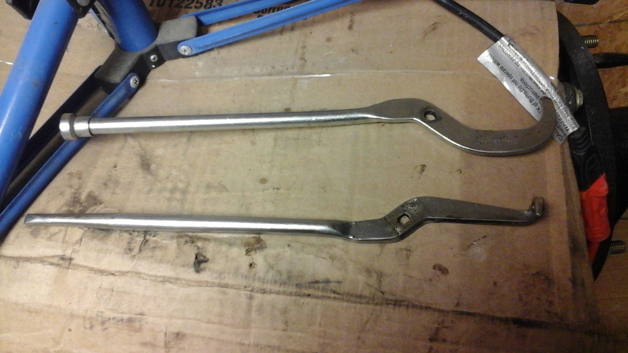

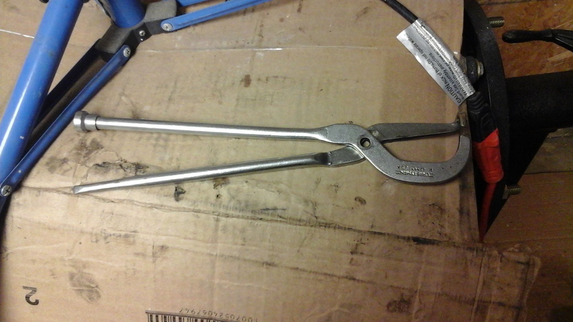

Now, some pictures of the crank sensor plug tool.
First picture...this is an old obsolete (like me) drum brake tool, used for removing and installing springs.
Second picture...is the two halves, after removing center bolt (which is already missing, took out earlier).
Third picture...shows the hooked end.
Fourth picture...l had to grasp the tool with some vise-grips to give me a better holding postion. The tool fit up between the drivers side inner fender and frame rail. You just snag the upper plug and push the new crank sensor plug in until it locks in place.
Without this tool, or something similar, you are really challenged at getting the plugs put back together. You only have enough room for one hand. Entire job took me ten minutes (vehicle on jack stands already).
