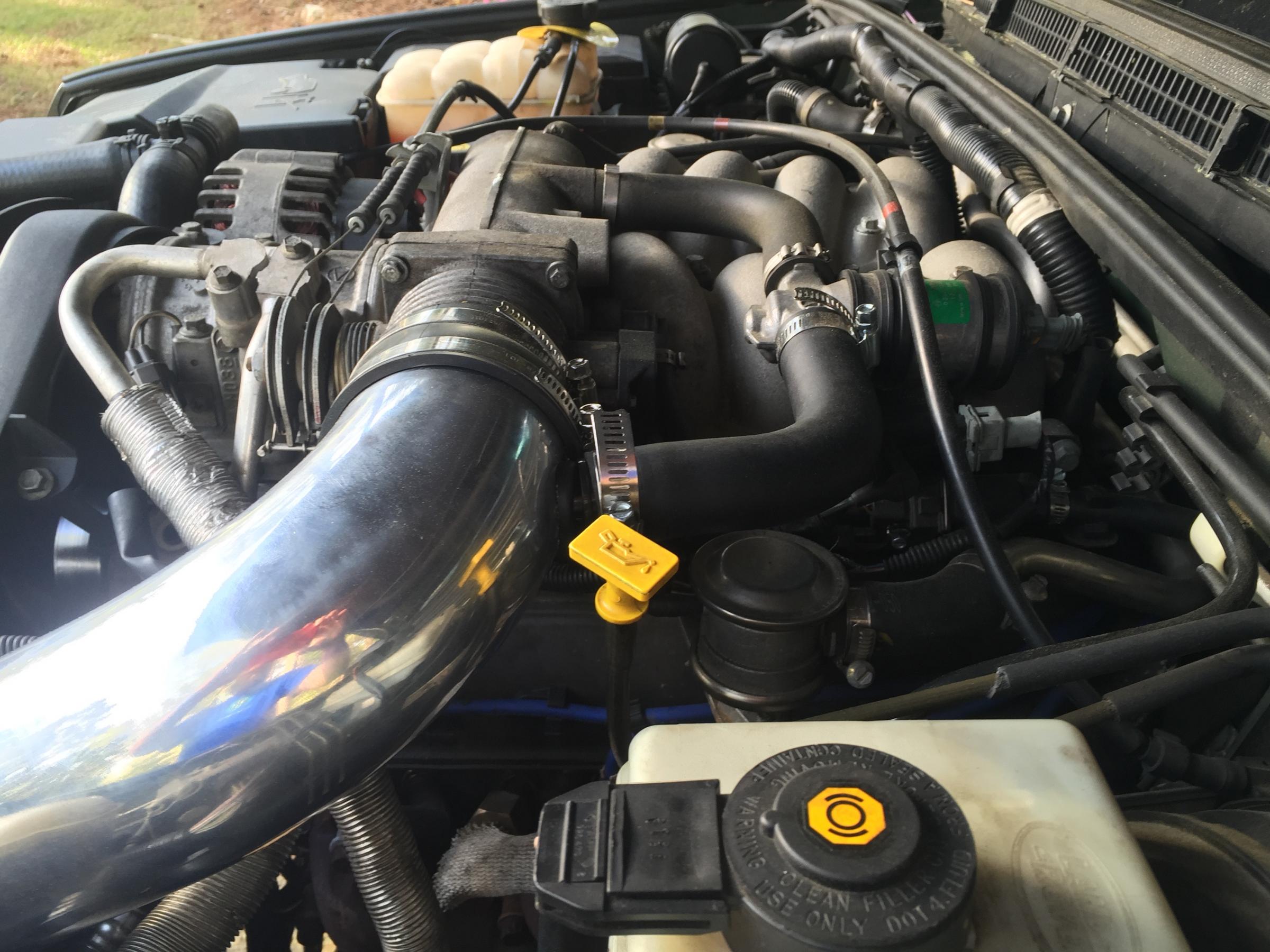

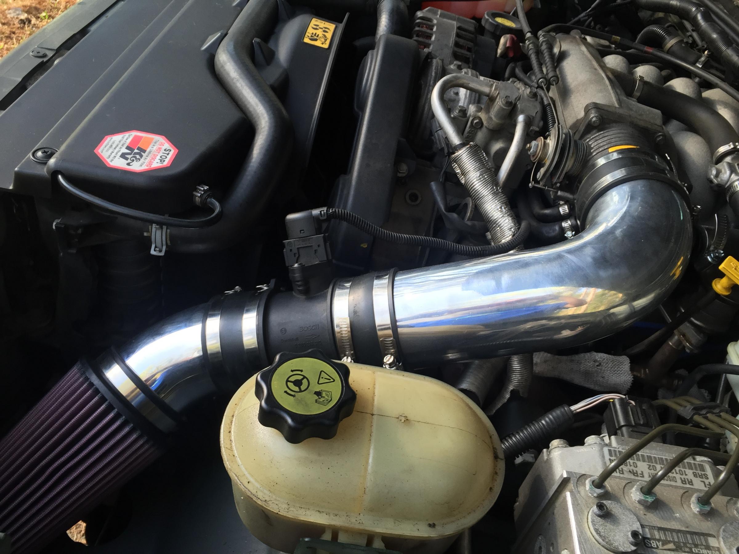

So as I posted on the What did you do to your disco post. Trying to take the airbag out for a good cleaning the woven portion broke. So I decided to custom build an intake for my disco instead to get rid of the restrictive airbox and intake plumbing with once again restrictive baffles.

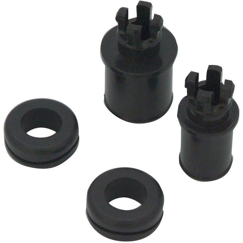

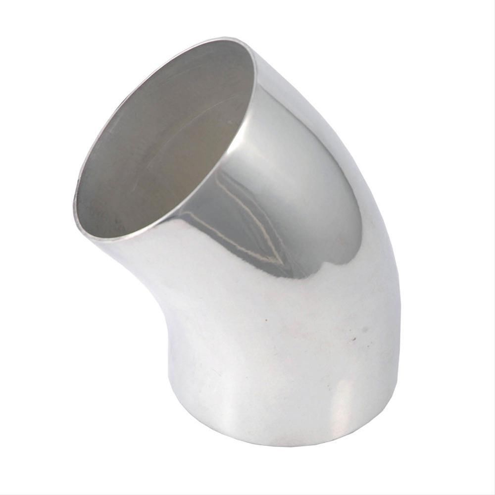

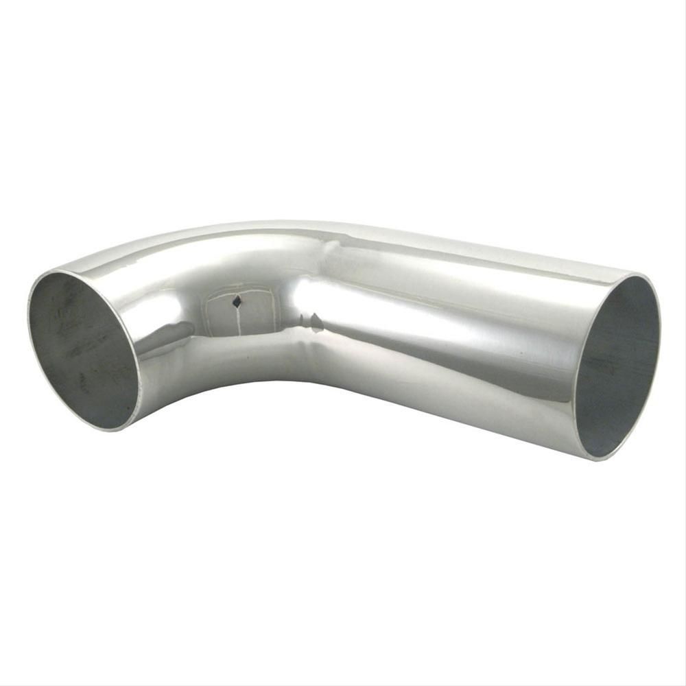

Everything I ordered was from Summit so I got free expedited shipping. First came the 3.5" piping. Parts used are from spectre. First Part is 3.5" 90 degree bend with 6" straight pipe part number 95990. Next up is a 45 degree bend part number 9549. A 25mm air fitting part number 9714 for the SAI. Lastly 3, 3.5" Silicone Coupling Adpters part number 9571.
Now that you have all the parts you attach the 90 degree bend to throttle body and mark the location to drill for the SAI. Once you have removed the 90 degree bend and drilled for the SAI you can attach the Air fitting and reconnect the 90 bend to the throttle body.
Put silicone coupler on and attach the MAF then put the 45 degree bend in place and attach the 3.5" filter of your choice.
Now I haven't got to burn through a full tank yet, but what I can say is that the truck is much more responsive. It also finally sounds like there is a V8 under the hood. For fuel consumption, I use an app for my iPhone called Automatic that allows me to track mileage and mpg. So far I have seen 2-3 more mpg on common routes. The real challenge though will be keeping my foot out of it now that it sounds so much better.

I would suggest wrapping the tubing in a heat shield insulation. I might do something like this but with the wrap to see if I can keep the temps down. Also a bent aluminum plate to block off the filter from the engine could give you more of a cold air intake function.

I like it! On thing to consider is a dry type filter on this, so there is no chance of oiling up the MAF sensor.

I'm using a K&N, don't remember which number. I just carried my MAF into O'Reilly and said "Hey, what have you all got in the way of K&N filters that will fit on the end of this?"
No issues after ~8k miles.
I don't know, I didn't take recording pre-intake for the temp. I can tell you, I made a plastic heat shield (can be seen in the link I posted) that made about zero difference on the intake temp.
