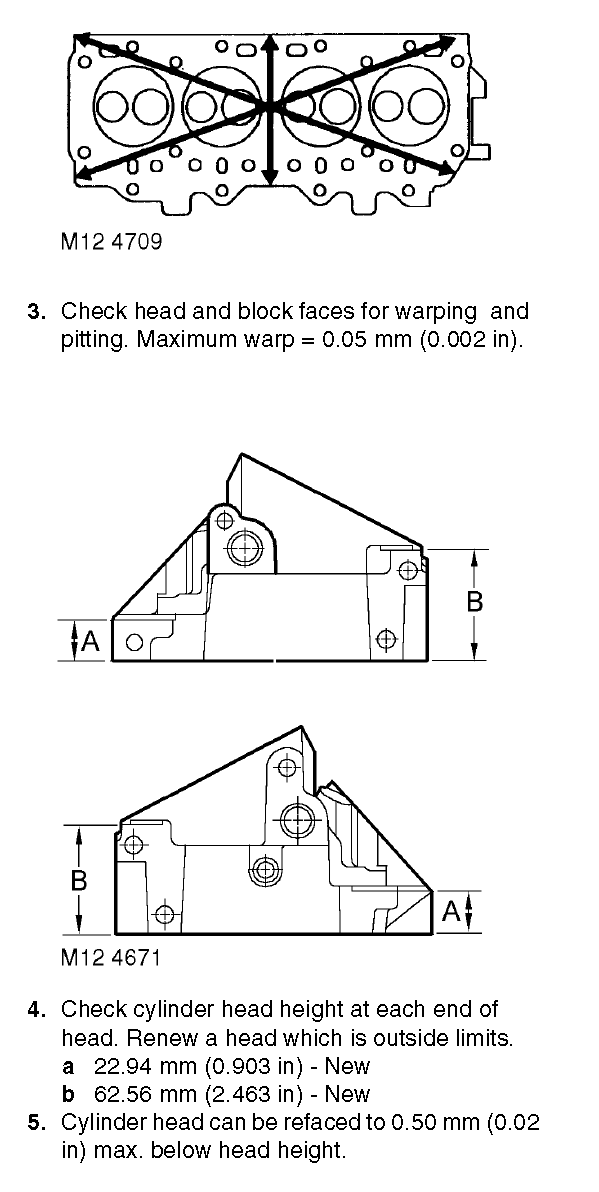

The heads are in storage now. Is there a way to tell if they have been skimmed? I'd like to have them cleaned up and a valve job before I break down the engine so I could do the entire job in one weekend vs. waiting on the machine shop to work on them after disassembly.

Measuring by the instructions in rave, this is for V8

The machine shop can tel you and a legit one won’t resurface if it’s going to take it below spec
While true, how would a "non-pro" know with any certainty if the shop is legit?
I would provide them with the specifications as noted above and simply ask them to measure and provide those figures. One extra phone call shouldn't be a high hurdle to getting the work done properly. Bring breakfast snacks / coffee and your experience might be enhanced.
