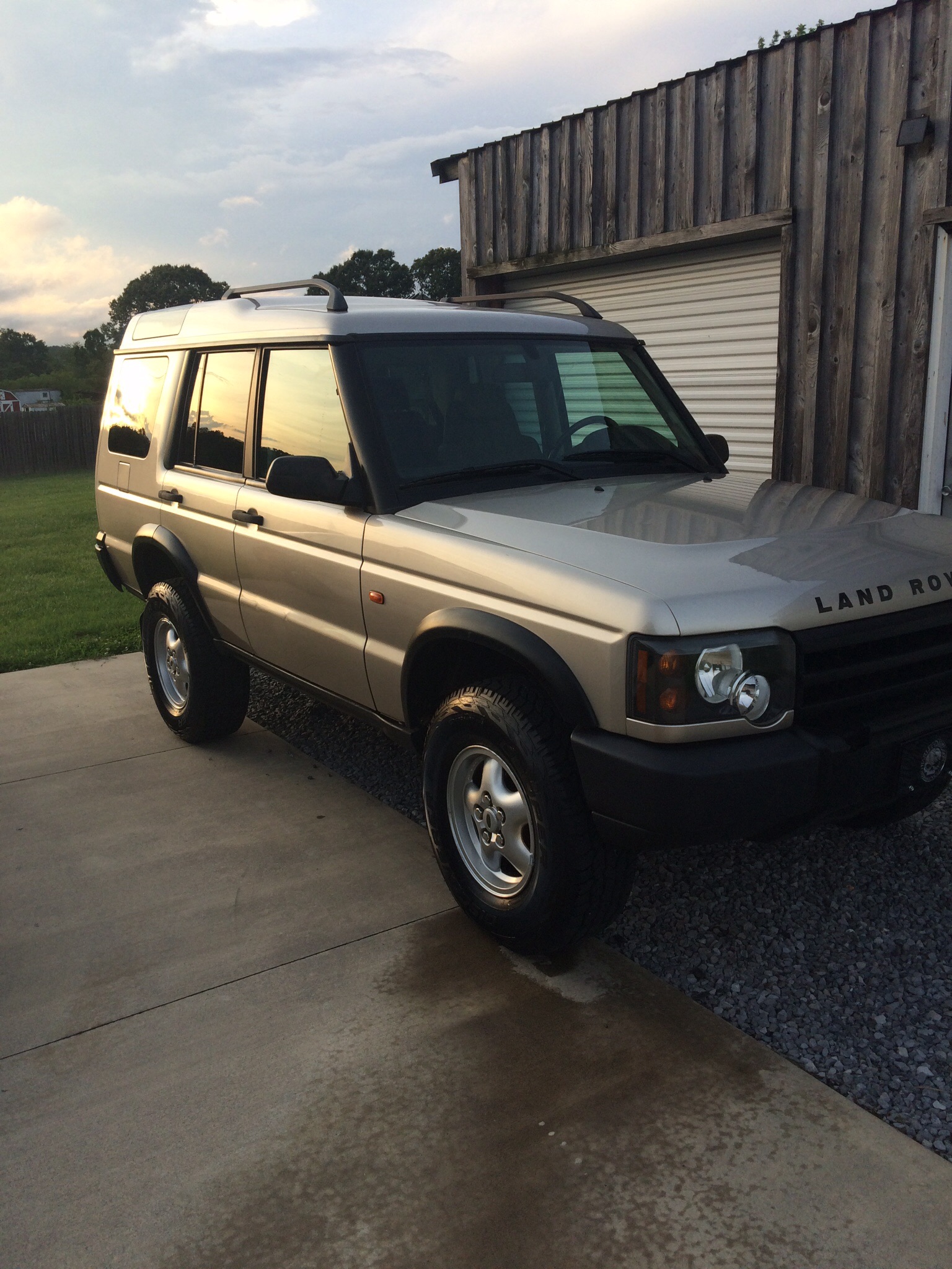

Default Just installed 2" lift
Just installed 2" terrafirma 2" HD lift and new 265/75-16's. I am very pleased with the looks and the ride quality.
