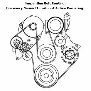

Its dark now but I did just read that incorrectly-routing your belt could result in inadequate pump pressure, but I find it hard to believe I did that. It looked like it could only go one way. Sure would make sense, though.

Seems like it would be difficult to get the belt on wrong.
Without ACE.
With ACE.
I hope you didn't get some leftover debris in the pump, before you swapped out the gearbox and hoses.
