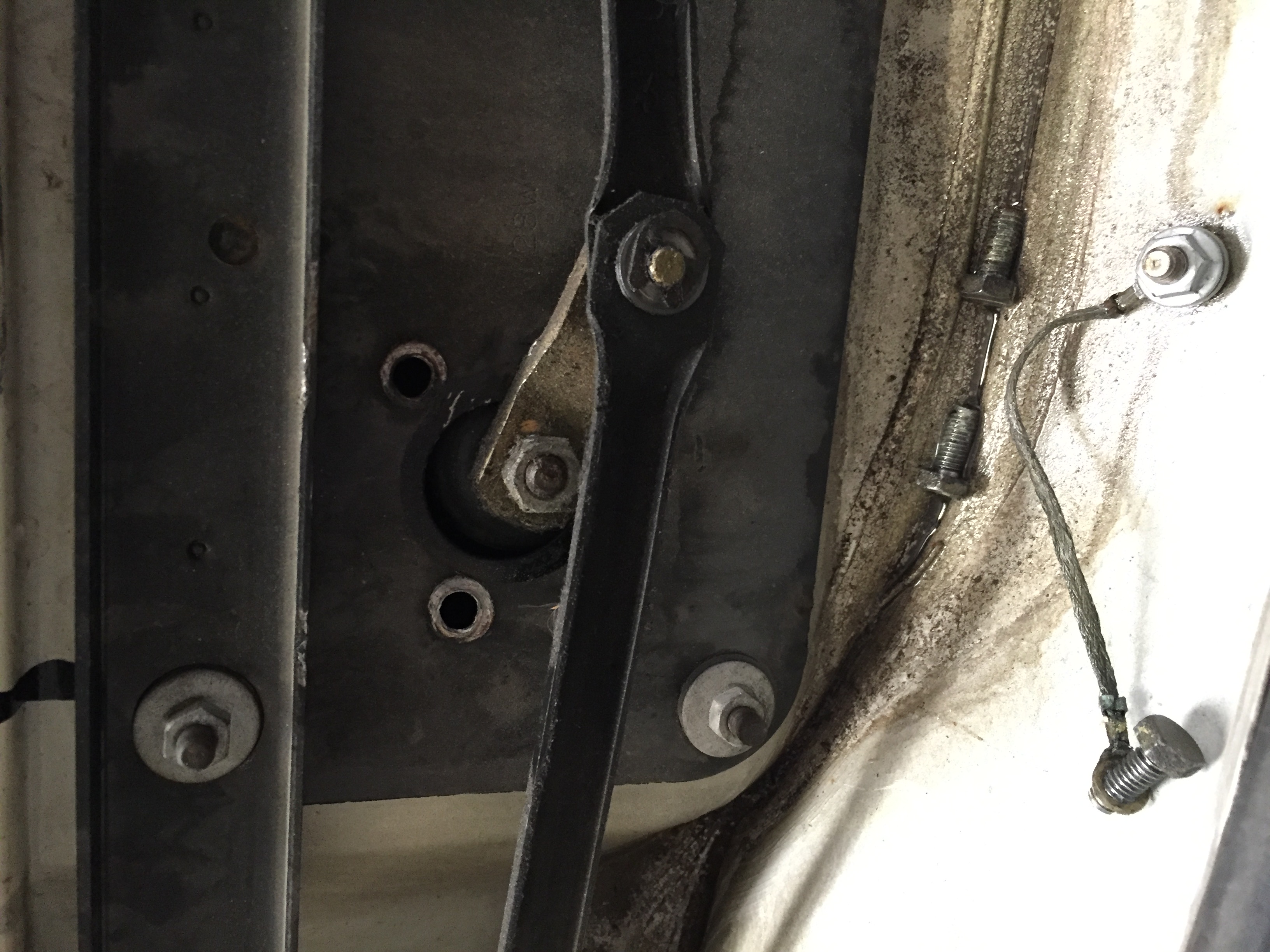

I finally pulled the Discovery into the garage to look at this issue. When I removed the cowl per the video (thanks for that), I was able to find that all 3 bolts had come loose from the motor and it was only connected via the linkage! Thankfully all of the bolts were still sitting there. So with a little wrench time and lock-tite I've got it all hooked up!
Took it for a ride in the rain today and it was like driving a whole new Rover. Previously the wipers always made this loud knocking noise, now they were whisper quiet. Also after cleaning the switch everything comes on immediately and works great.
