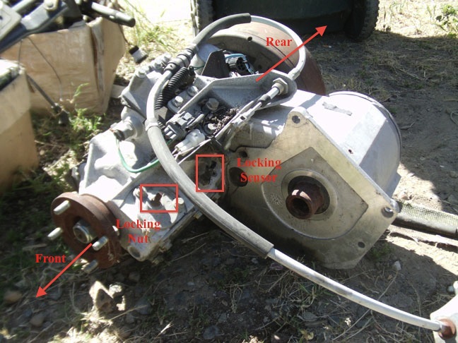

Silly question, have you added the linkage to enable/disable the locking diff? There is a sensor that plugs into the top of the transfer case, and if you unplugged it, that diff light should never turn on. I'm guessing either a sensor or that the diff has somehow managed to lock itself? I'm also assuming that the diff lock signal is what mucks around with TC and ABS, since I read somewhere that once you engage the Diff Lock, it decreases the sensitivity/functionality of ABS and TC... Not my picture, but my markings. Let us know what happens.
