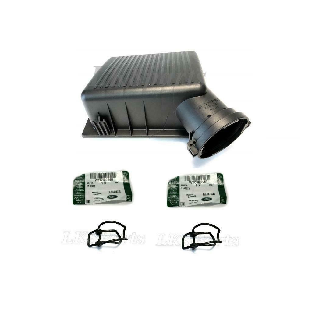

Question. Disco 2 99-02 and 03-04 has different part number for that part. i cant find any difference in pics. Is there is one?

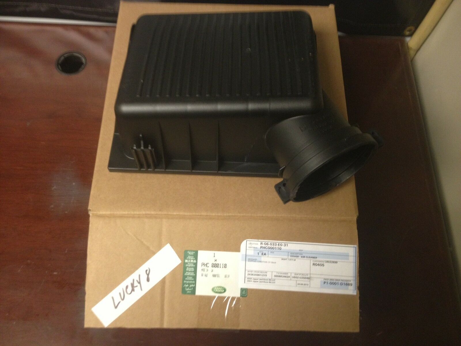

99-02 = 4.0L V8 which had a smaller intake tube/MAF body/air box lid. The 03-04 4.6L had a slightly larger intake tube/MAF body/air box lid. However the MAF sensor itself = identical.
People will argue with me here, but you can run either of those on either engines. Reason I say this = the Throttle Body Assembly on both engines are 100% identical. Which means the difference in performance is so TINY LR didn't even bother to bore out the 4.6L TB housing to actually allow more airflow into the engine.
