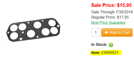

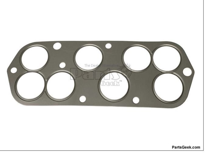

Can anyone show me what the intake gasket looks like? I'm trying to look it up but its showing me 3 different ones and says none of them will fit mine. Also I found a set of 4 hole spray injectors that says it's a performance upgrade. Has anyone installed these and if so what kind of results did you have?

The intake gasket is part #: ERR6621
While you have the intake removed you might also consider replacing the Valve Cover Gaskets # LVC100260 and the Throttle Body Heater Plate and Gasket # MGM000010KG.

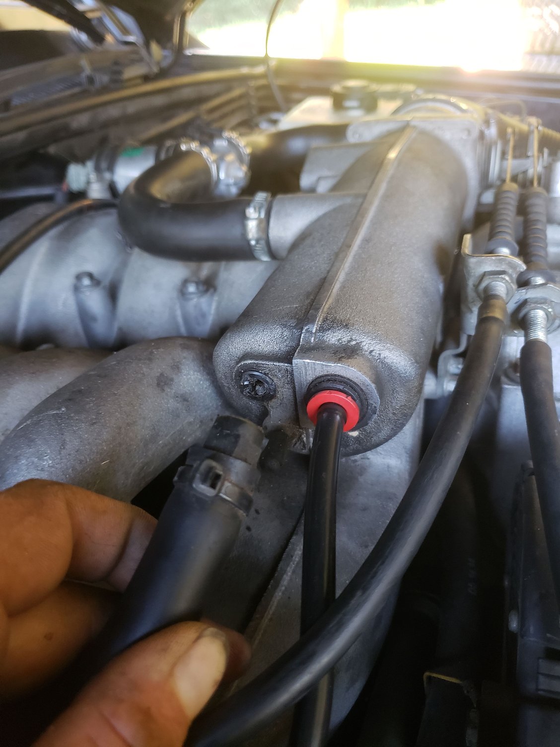

Ok guys i need some help. I was able to remove the intake and put in new coils and wires and get it back together with a new gasket but i broke this fitting on top of the intake plenum. Now my truck will fire but will not run. Is this a vacuum line and if so how would i fix it?
