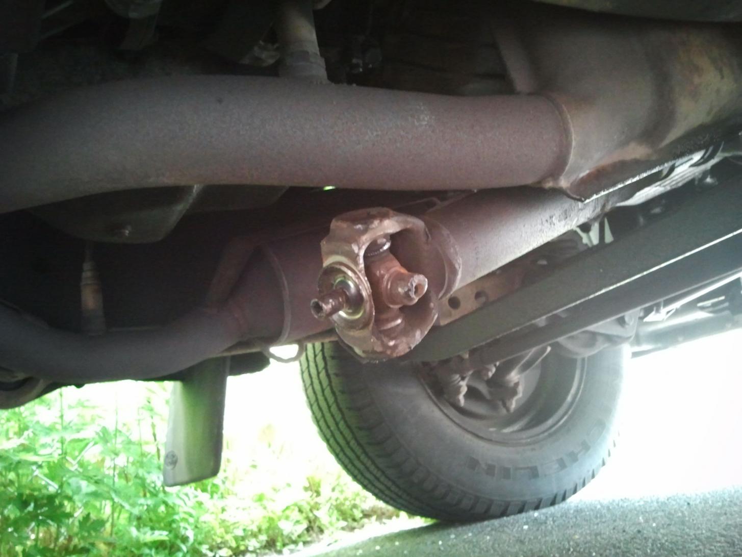

Welcome. Please check front drive shaft, if still oem style with no grease fittings on double end, you risk failure which breaks the shaft and allows it to beat hole in transmission. Also, the heat gauge cannot be trusted, it will stay at 50% from 130-240F. Use a scanner or Ultra Gauge for accurate temps. Coolant loss is serious.

Yes, problem umpteenth, (possibly original) but definitely the an OEM style front shaft (no lube nubbies )

Here's what it can evolve to swiftly. Rebuild article in our tech area, under $100, or replace or have drive line shop rebuild.
Also pic of scanner readings for two differnt heats, two different trucks, same gauge reading.

Yes - critical. Danger Will Robinson. You MUST grease the drive shafts. Must.
