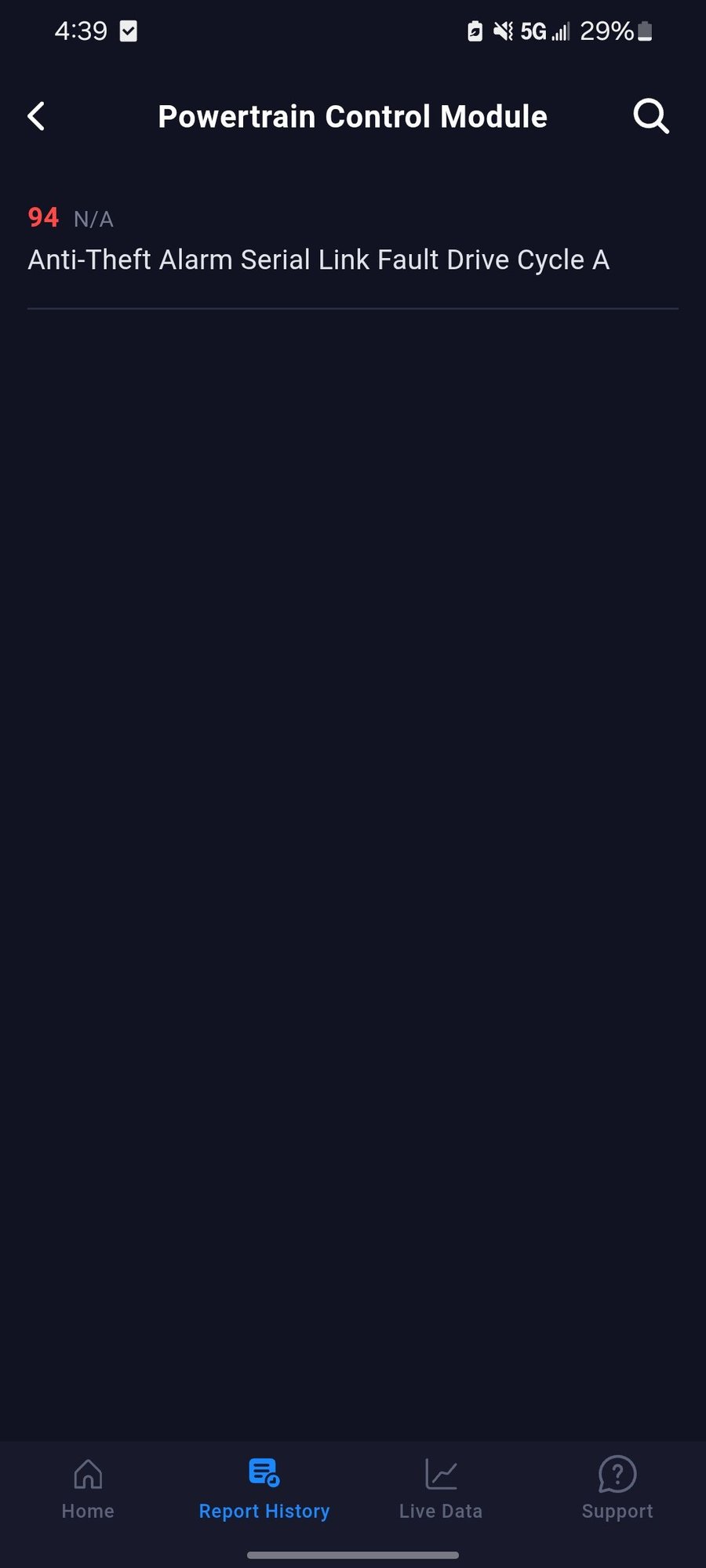

When I hold the key to the unlock position for 5 seconds nothing happens to begin the code entry sequence. When the car is unlocked the security light stays off entirely so I'm not too sure whether the immobilizer is actually the case now. Also the two codes I got after scanning are in the pictures.

I did that and it worked to unlock the truck, but it didn't change anything with the immobilizer state. Not quite sure what my next step should be other than maybe somehow tracking down a nano-com to use.
