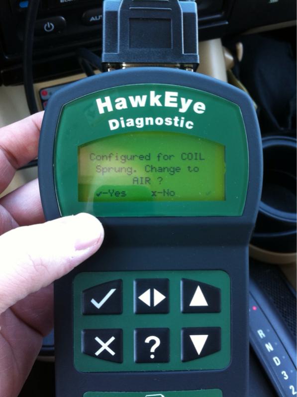

I don't believe they are right. I think you can change the setting back.
Attached Thumbnails disco dash making ping noise at 30KMh-image-1538387338.jpg

yes, you can change your slab back and forth from coil to air as Jafir showed, so I dont think that is your problem
very interesting..... am i being fool? u know what, most of disco 2 owners here with air springs change to coil when slabs problems show up~ it's not cheap doing conversion although the process seem simple.
Where can I get the diagnostic tool? anyone has one for rent
