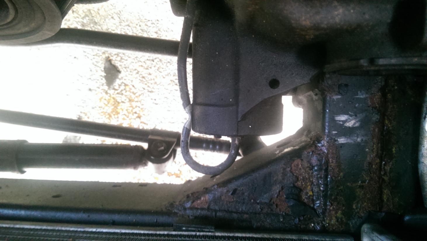

Default well it gets worse :(
I just noticed this bent tube on the steering unit upon further inspection. See pic below. Not sure if the fan did that (angle seems off), but it doesn't look good. Any ideas if this is repairable?
Attached Thumbnails Disco II fan exploded -- need some help-2014-08-08-06.50.22.jpg

that looks like the high pressure line from the power steering pump, it's possible you could repair it with compression unions.

I believe this is the part you are looking for. You don't have to buy it new. This is one of those parts that is okay buying used. It doesn't spin at high speeds like the fan move and it likely won't destroy anyhting else if it fails. HOSE PAS PUMP-STRNG BOX DISCOVERY II, RNH076, QEP105481 - Rovers North - Classic Land Rover Parts
