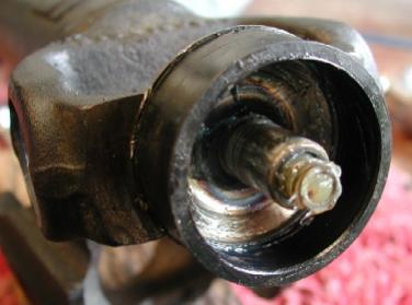

After reading the responses now I have to do it. Ashtray: just want to make sure that we're referring to the same dust cap. It's shown in the attached pic, forming the walls of the cup at the end of the shaft.
