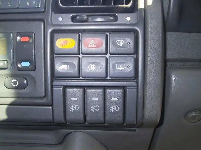

I am looking to add some additional switches to my D2. I know the D1 had the neat two and three gang panels where our coin tray and ashtray is currently. Are these direct swap-in? If not, has anyone ever swapped them over?

Yep, that fits. It used to be a common modification.
Just know if you put it in a facelift 03/04 the fascias are black so it doesn’t match the color. Better for 99-02 in other words, if you care about such things.

The D1 panel works but the switches aren't standard so I opted to 3d print this panel which fits in the same spot and uses carling switches.

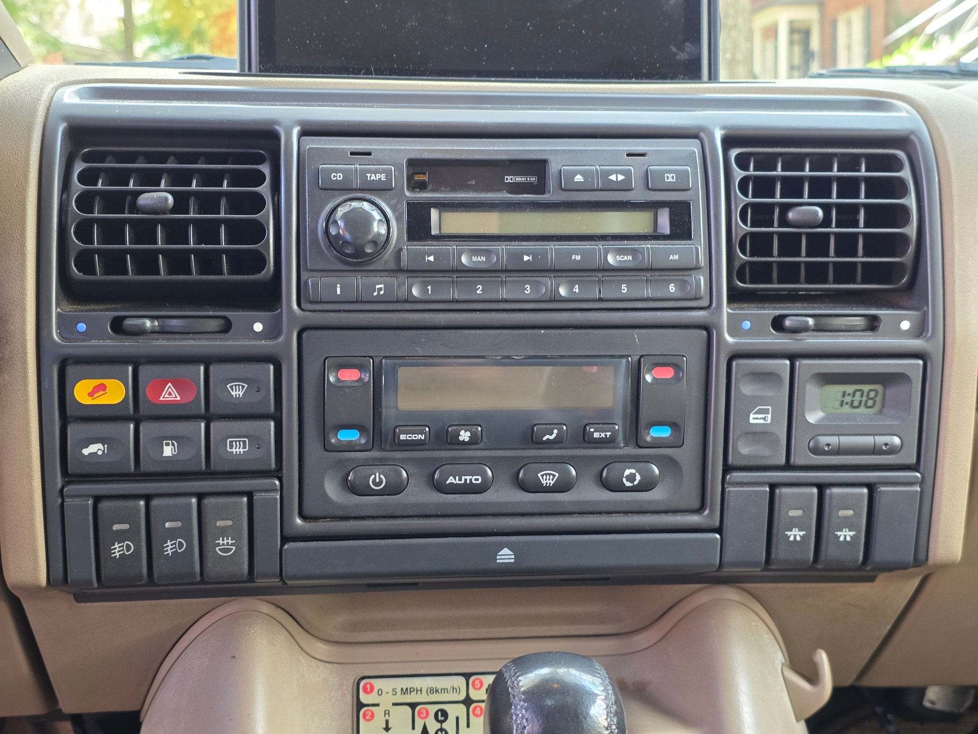

Hey guy, got it all installed. I am big time switched up now:
The brackets are a little hard to find with tabs intact, so I CAD'd up one:
https://www.thingiverse.com/thing:7196432

A great modification !
