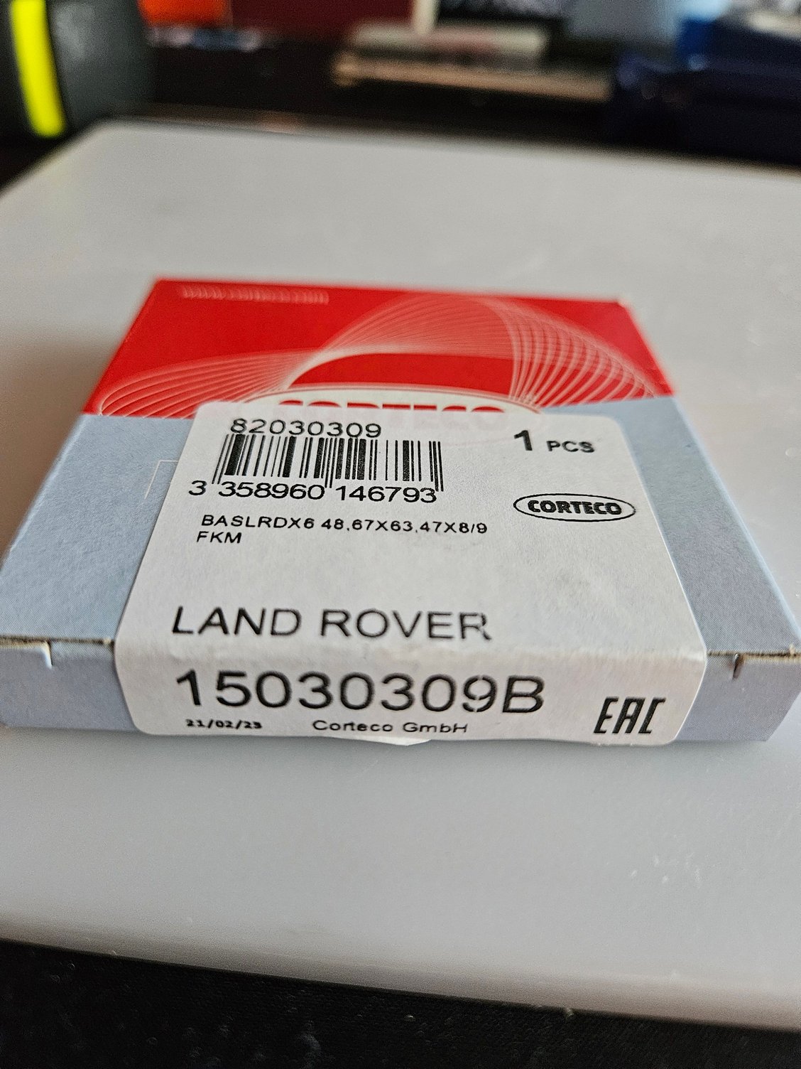

So, I did my research thing, trying to see if there was a better fix. I saw someone somewhere refer to the fact that the Corteco seal was a smaller diameter, but I couldn't find any actual info to confirm it, so, I bought one to find out for myself.

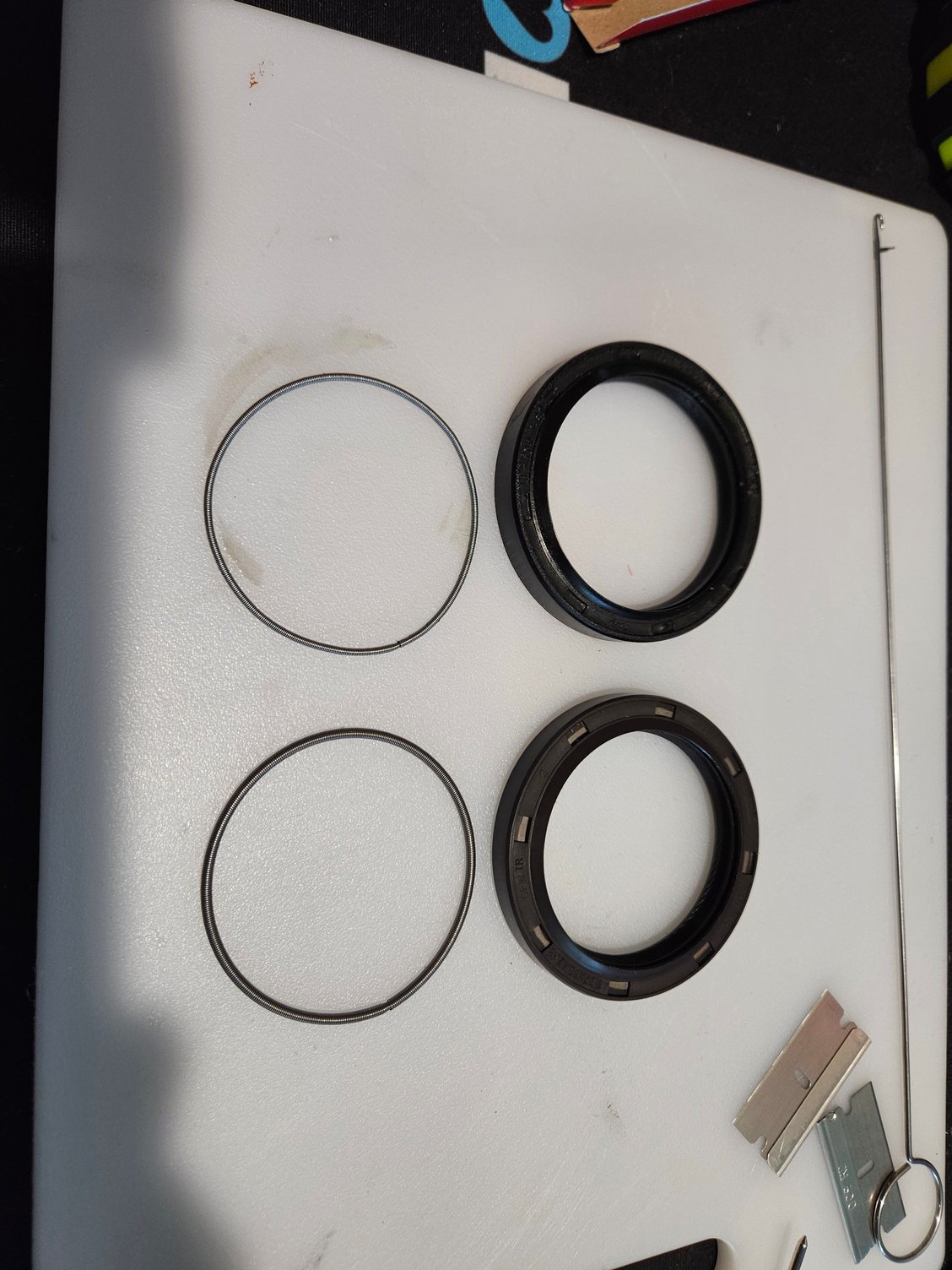

Yep, this seal is much tighter on my sleeved Harmonic balancer shaft, and, after a couple weeks driving, I still have no leaks. I took a couple pics to demonstrate the differences in the seal spring, which are blatantly visible...
LR OE seal on top, Corteco seal on bottom. Obviously a noticable difference in spring diameters...
Corteco P/N 15030309B
I did not think to measure the Corteco seal before I put it in, but I did find it reported to be 1.917" inner diameter.
I measured the LR OE seal that I removed from my Disco to be a 1.935" inner diameter.
Perhaps my 9 month old used seal was opened up wider than when I put it in, I don't know, but I think it's pretty easy to see why it was leaking from those measurements.
I'll keep an eye on it, and report back if/when it starts leaking again. But for now, this seal has already lasted longer than any of the OE seals I wasted money on. Hope that helps somebody....Good luck guys 👍
