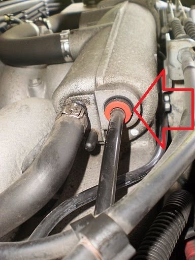

Mine felt very sluggish but I have a snap on smoke machine which helped me find leaks mine was on the intake manifold. Really helped performance. If you don’t have one I think you can spray carb cleaner around? Look it up thay or starter fluid. Spray around like the intake manifold gasket and whay I have labeled if the rpms jump you gotta leak. There’s videos on YouTube to follow for this it’s not perfect
ok great idea, I will check it and update asap.

Ok so I checked the whole motor running with carb cleaner and starting fluid just to make sure I wasn't missing anything and nothing changed with the RPMs. Could it be a sensor lock the crank or cam or a worn timing chain with slack maybe?. The only reason I'm thinking the torque converter is locked is the RPMs fluctuate with the press of the accelerator until what I'm thinking is locking, then when you push the pedal no RPM changes until it downshifts to a lower gear or it unlocking again.

Like I said the carb cleaner trick isn’t a definite I tried it on mine before the smoke machine and with the machine I found 3 different leaks. If you can find one to rent near you or a cheap diy one I seriously would advise it. Super powerful tool to solve a lot of problems
