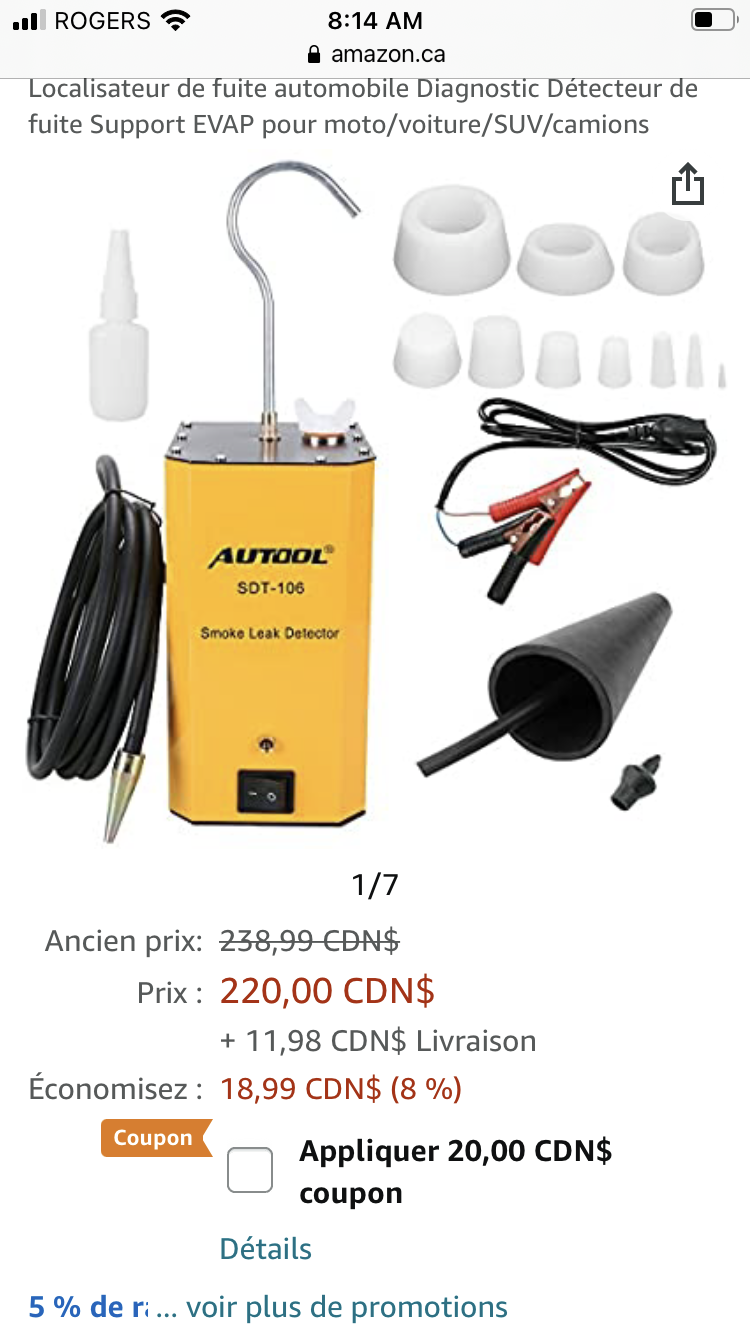

redwhitekat's Avatar
Joined: May 2011
Posts: 2,768
Likes: 396
From: kitchener, canada
Sounds like your transmission is slipping maybe
do you have any codes ?
I know when my battery was low my tranny went into limp mode you can hit the gas all you want it won’t go anywhere fast.
I would check you battery volts
also I just bought this smoke machine
with the discounts etc it came out to $200 Canadian all in
