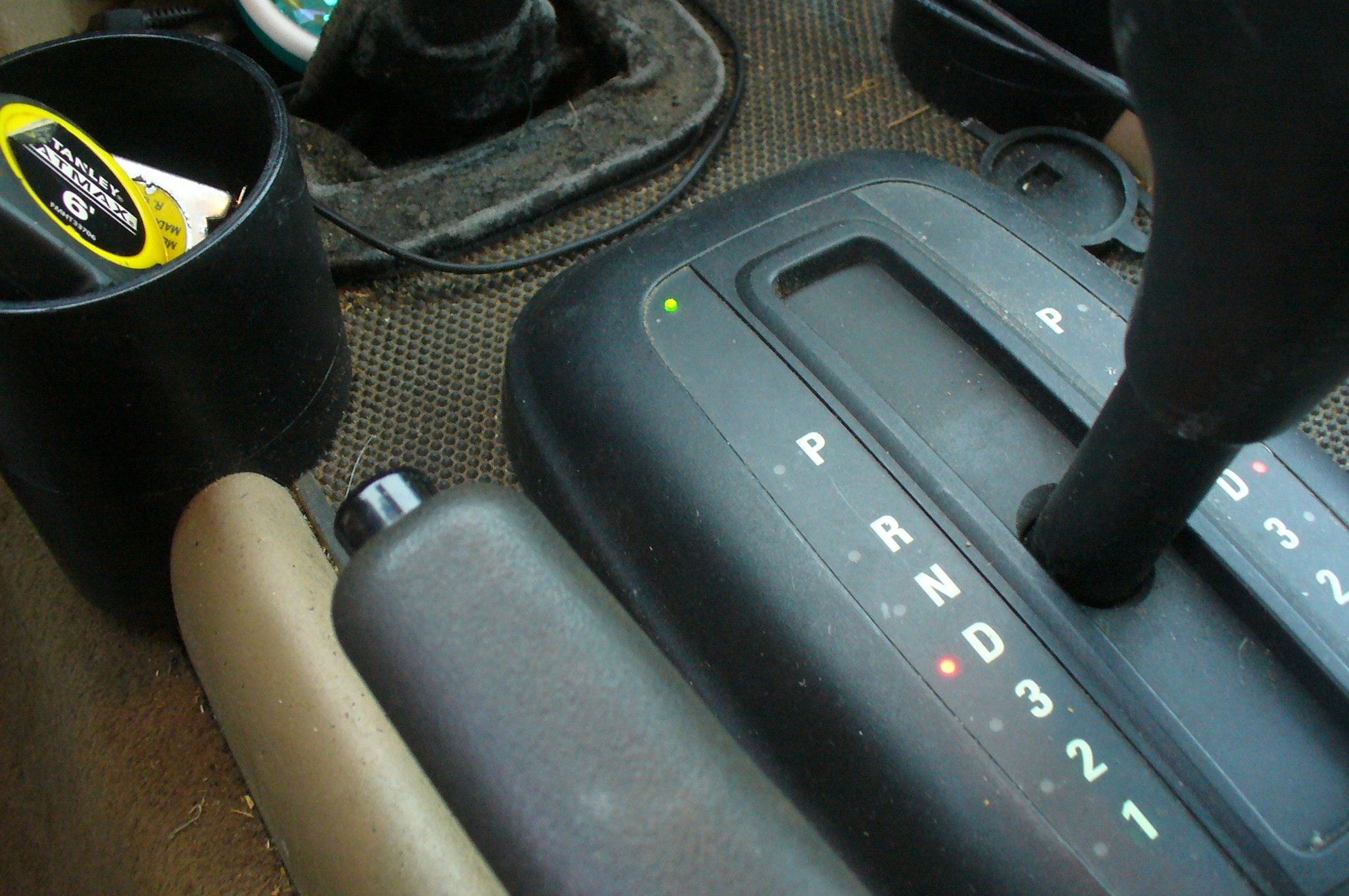

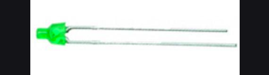

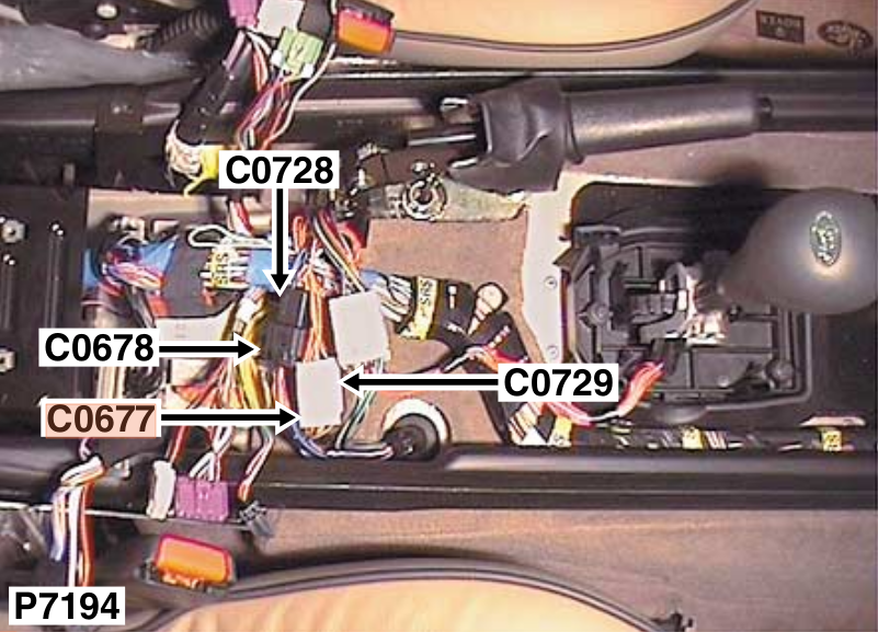

Hi !
The LED is of the 2mm tiny tip type force pushed from under the plastic gear selector shell to a tight hole drilled where shown above, wired as to turn ON when the torque converter is in operation, and OFF when locked. Of course other sizes, colors can be used.
Its electronic symbol below is -----|>|-----
C0677-6(+)----------------------|>|--------------------resistor 1000 ohms------------------------(-)ground
Connection points are ground (taken at a nut by the parking brake lever base; and positive at the grey/red wire on connector C0677-6 accessible behind the windows control panel. Tiny telephone wire does it routed to the location of your choice.
