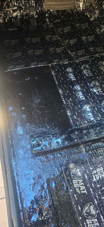

What now I have noticed on the drivers side(LHD) is a bit more disturbing, I wanted to check that side too which is mostly dry but now not The screws of the trim piece that holds the carpet is gone, literally cracked all the heads. I will remove the carpet after the new year day, wife is already pissed at me Attaching some photos from under the carpet as well. It does rain substantially today so lets see on thursday or friday.
What I have noticed is that the underneath of the screws is completely empty, so once removed you can see the floor hence the water goes in is my theory. But need to investigate more as this is also disturbing that I do not find water from the roof, nothing drips from under the steering or around. It either comes from the corner as a second point and also from the trim piece that holds the carpet. This repair has gone very beyond and now I am so invested, I will go in deep I do not know where all the parts are and would definitely need new screws for everything

One thing I learned by doing this type of repair is that the damage will be worse then what your looking at. Prepare yourself! I would remove that black sound proofing membrane on the floor. One area to inspect is under/around the brake booster. Start at the steering components coming out the firewall and across to the corner by the wiring harness. I had a hole that was around the steering. Couldn't see it inside because of the second plate in the footwell covered it up. Water flowed in behind that plate. I would also remove the plastic trim on the outside sill. The seam sealer behind the front 1/4 panel was gone. I resealed those as well. I ended up replacing the inner and outer sills/ footwell/ lower side and almost half the floor. I posted some pics because it can seem over whelming but it's achievable. Good Luck!!
Someone stole the seam sealer. It was leaking on the inside wall.
New seam sealer and paint
New floor!
New floor!
