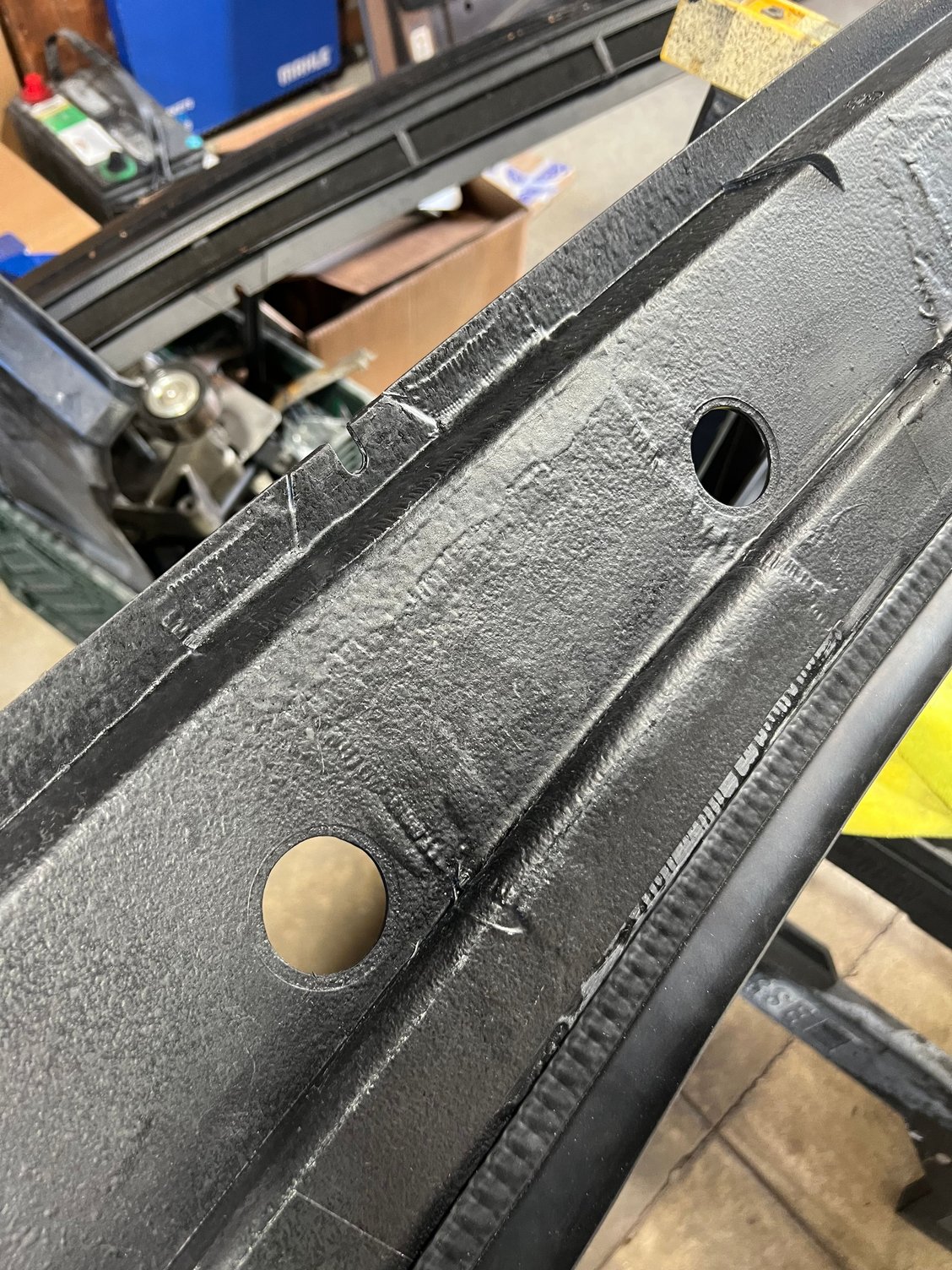

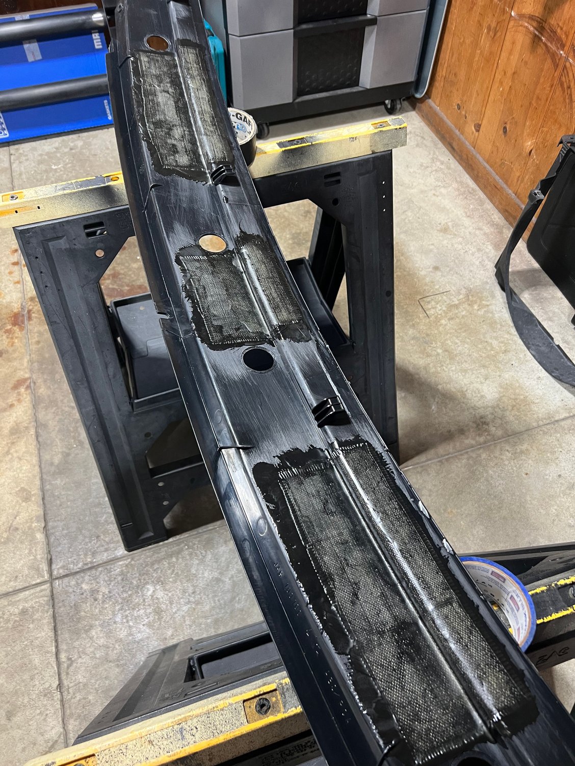

1 - Added some fiberglass to the back side to keep it from eventually cracking.

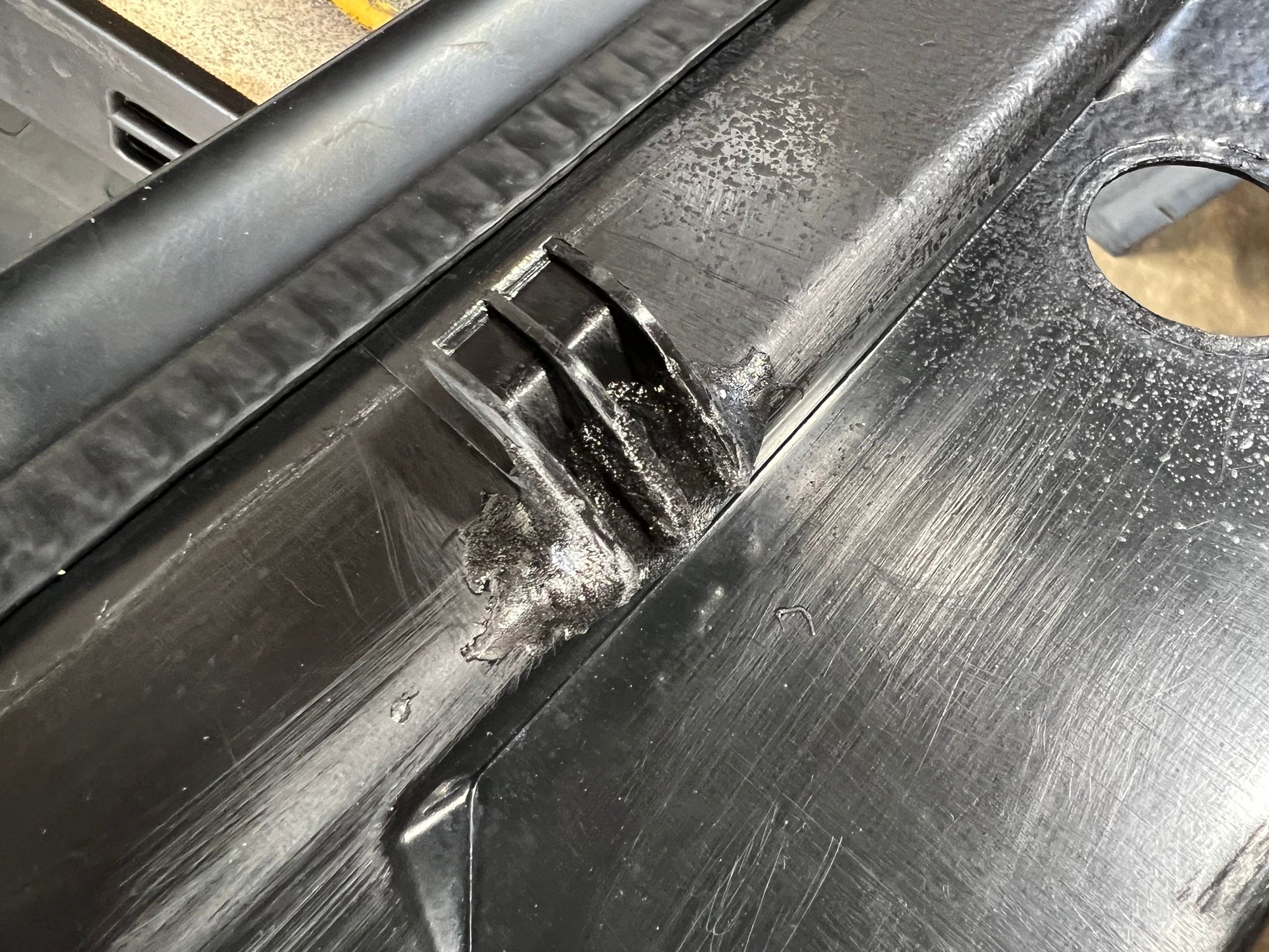

2 - I reinforced the tabs that hook under the bottom of the windshield with JB Weld plastic bond.
3 - Coated the fiberglass patches with black FlexSeal paint.

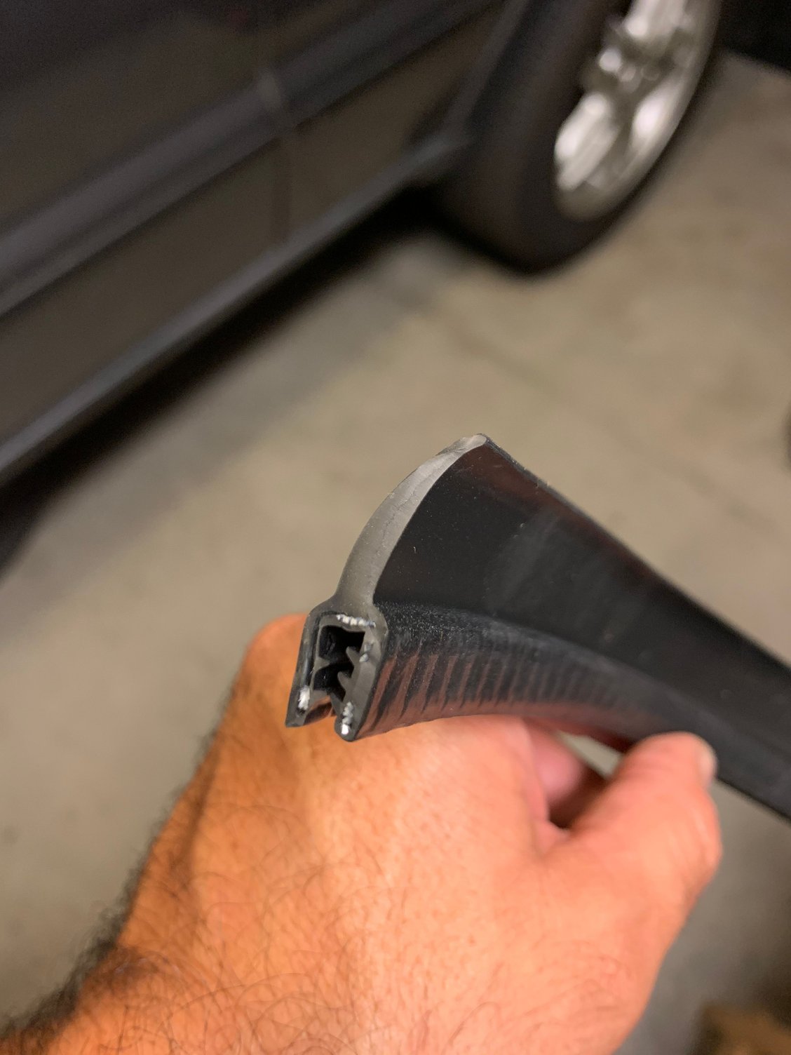

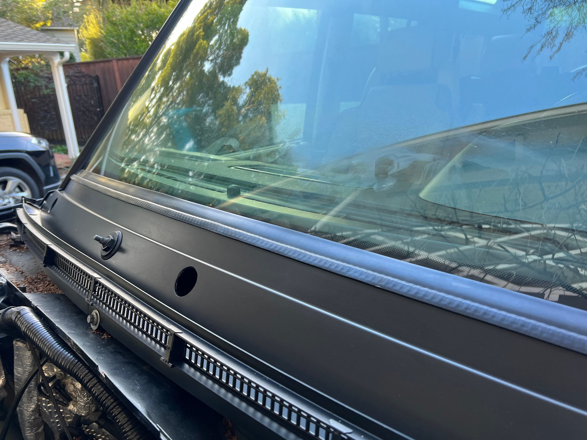

4 - I painted the exterior with SEM Trim Black using their Adhesion Promoter and then I replaced the rubber seal with a larger/thicker edge seal I bought off of Amazon - I also put the same edge seal around the inlet for the cabin fan - posted this in an older thread. Link to edge seal -
Amazon Amazon
Now I'll just have to see how the stiffer cowl holds up over time.
