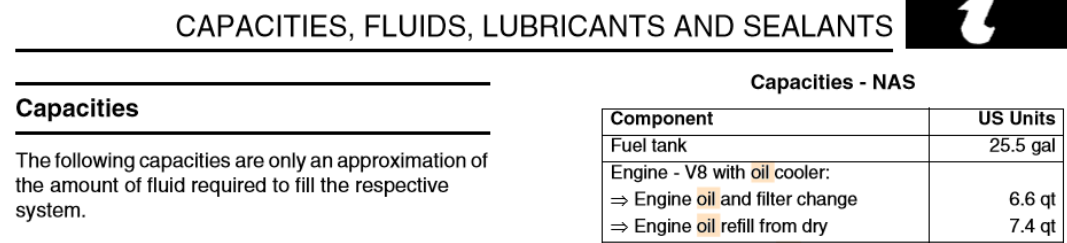

2) I installed 6.7quarts oil, yet, Rave says something like 7.3quarts. Why is the dipstick reading past the full
mark?

You have too much oil in the engine. The spec is 6.1 quarts with the proper filter like a Purolator L14670. Since you have a fresh engine you may need up to a pint of additional oil on the first fill, then 6.1 quarts with an oil and filter maintenance.
Trust the dipstick.

A little low on oil is better than a little over, maybe drain some out. Def get a temp monitor device, the needle is worse than useless, does not show hi temps, just engine killer hi temps.

This is why I put 6.7 quarts in. The Rave says 7.4 qts. W
th? Like I said, oil is over on dipstick.....Go figure.....lol

Did you blow out your oil cooler/lines, while rebuilding? If not, this may contribute to the higher level.
