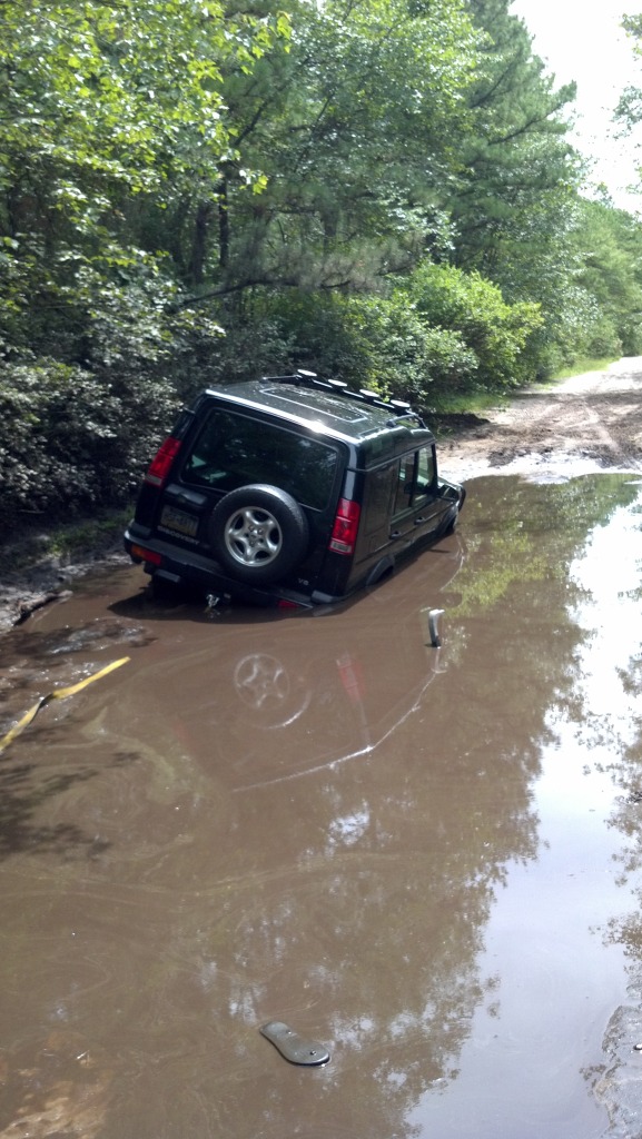

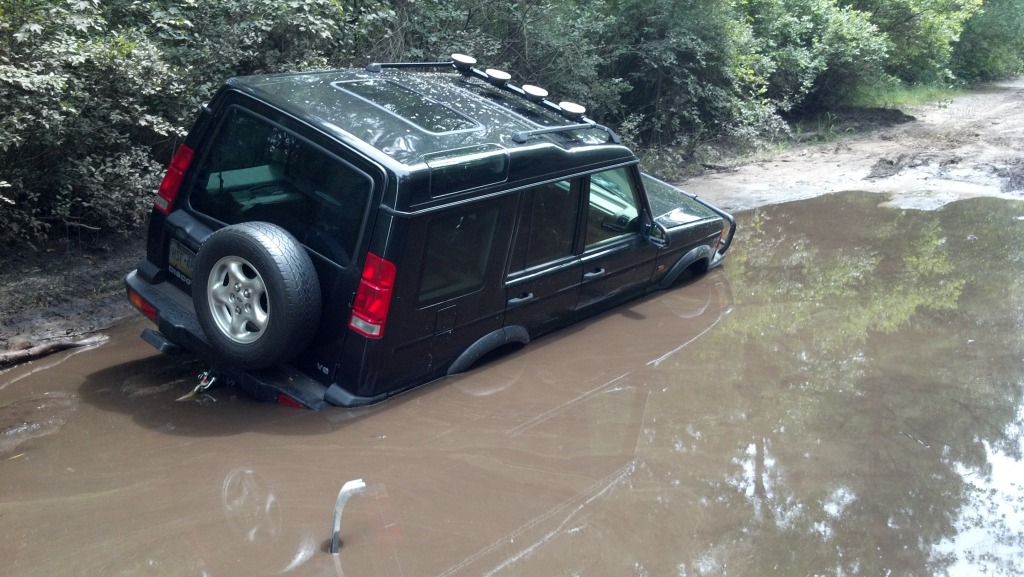

I've got both a D1 and a D2. I'd definitely trust the D2 in deeper water than the D1.
That said, I have a snorkle that I've very carefully sealed. A tougher part to seal is the doors though. In the D2 you had better make VERY sure your door seals are good. The tranny ECU sits under the driver seat and even door seals that look OK can be shot.
This little episode resulted in 8"+ of water in the passenger front foot well...

my girlfriend still gets mud on her socks when she takes off her shoes.
