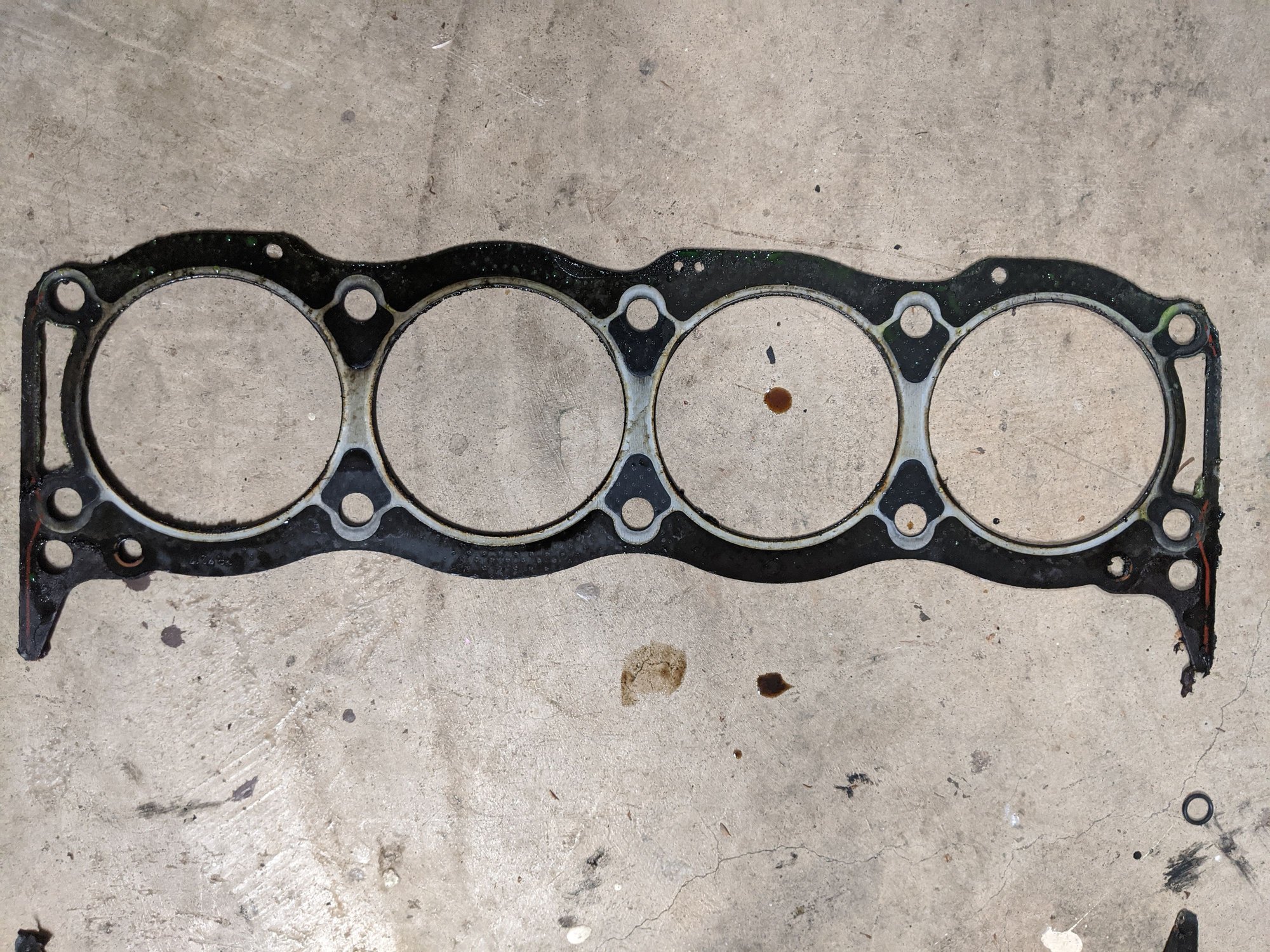

We finally had a little time where our schedules lines up and we removed those last 4 bolts....Can't believe we made it that far without any issues and then missed something so blatant, but I'll take it.

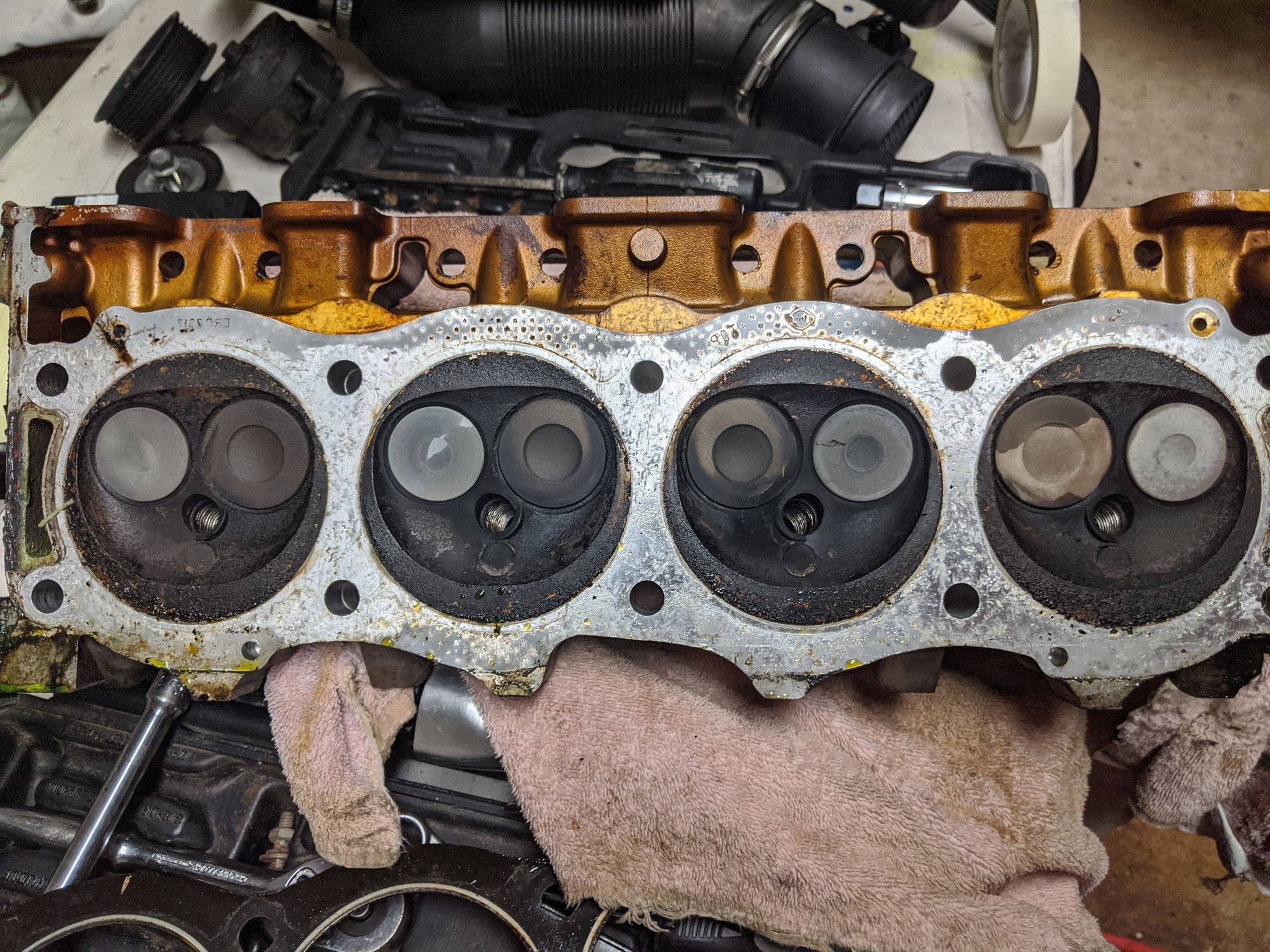

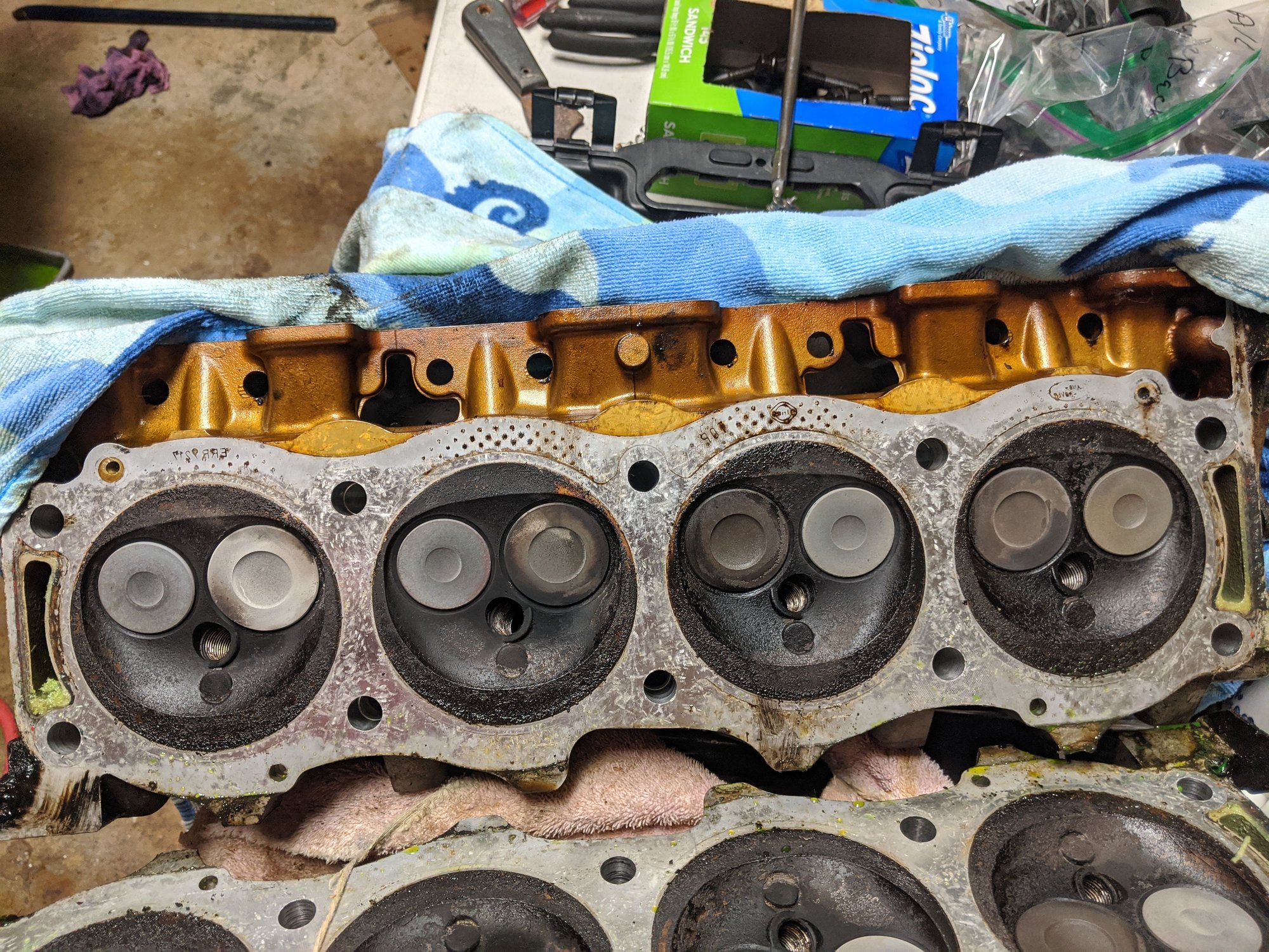

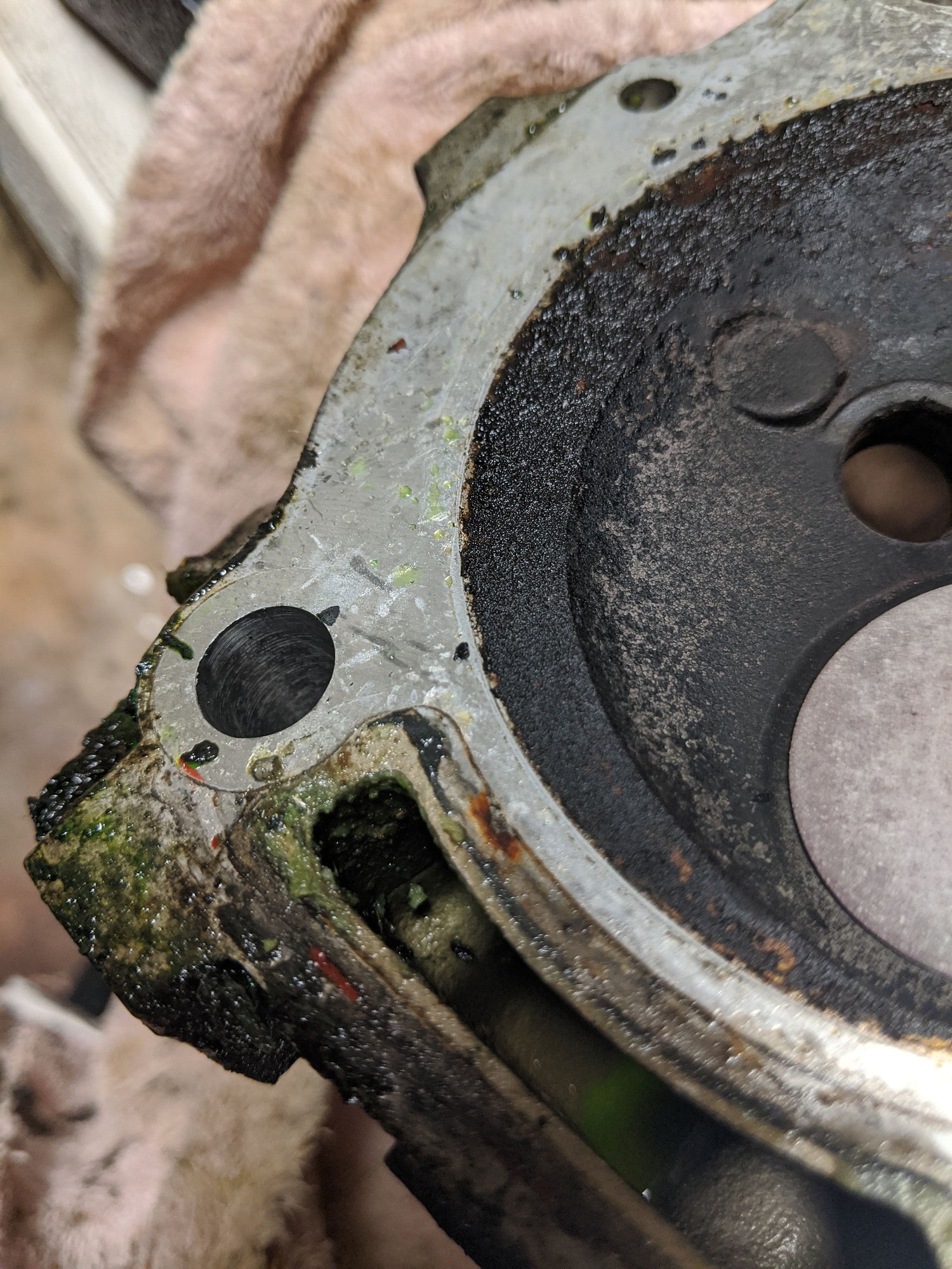

As everyone else expected....the heads came off with ease now that all the bolts were removed. This is the first time i've ever looked at the cylinders, so it looks fine to me, but now I'm looking for guidance. One of my biggest fears has been a slipped liner. However, I don't see any cylinder that looks steam cleaned and none of the cylinders had marked the gasket any more notably than the others. The gaskets were not stuck to the block or the heads at any spot and came off effortlessly. I don't know if that is a good or bad thing. Going to try to post pictures. I don't see obvious bad spots in the gasket, but I had multiple coolant leaks at the corners of the block and I did't see any thing above the block that appeared to be leaking. Anything particular I need to be looking for here? I'm afraid to get too excited, but it looks like the block may be in good shape. Removing the heads spilled fresh coolant all over the place which makes it a little harder to tell what was already there.

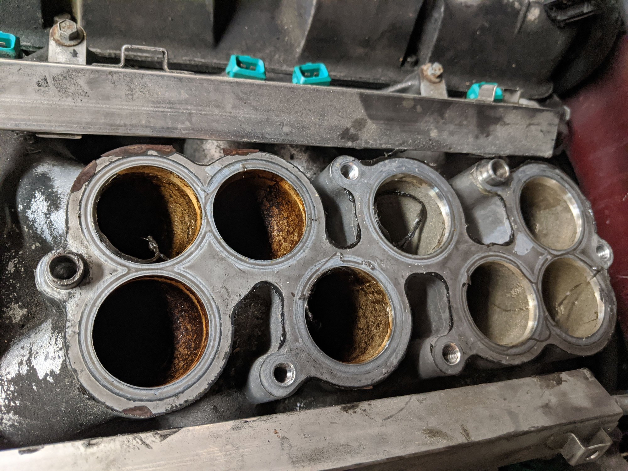

Is the coloration difference between the back 4 and front 4 typical?
This looked pretty rough. Noticed that the back two ports were clean (except for spilled coolant) while other ports were much dirtier.
Bottom side of each gasket ring looked consistently similar. Small indention around the ring, but none more than others.

@entjohnson your upper intake looks weird, all my ports were dirty those back 4 look way too clean to me.
  • Looks like some kind of stop leak was run through your cooling system the jell looking stuff in the head cooling ports
  • As well your gaskets look pretty good are all the pistons black ?
  • And you do not need RTV on the upper intake gasket

Normal worn out gaskets, how many miles? Did you get all the valve cover bolt bushings? I would recommend replacing everything not metal in the cooling system, last thing you want after this work is an overheat due to a failed hose or plastic part. I also highly recommend the inline thermostat mod. The PCV mod is a must do. If you have the radiator out, now is a great time to replace the front crank seal.

The back 4 intake ports are a bit confusing. Perhaps a bad valve seat? It might be worth laying the heads out and filling the combustion chambers with alcohol to see if any cylinders drain out abnormally faster than the others, indicating a bad seat. Otherwise that block looks pretty much the same as mine did. I kind of agree with Extinct here with regard to cleaning it, however if this were mine I'd pull that engine out of there and clean it up, it's giving me the heebie jeebies! It will be a lot easier to identify any leaks down the road if you start with a clean engine. The cooling ports do look a bit gelled, that could be the effect of swapping to green coolant without draining all the Dexcool. The good news is that the old headgaskets don't look too bad. A slipped sleeve will leave an indent in the gasket so inspect them carefully. The pics don't look too damning and I don't see any breakouts where coolant was getting into the combustion chambers.

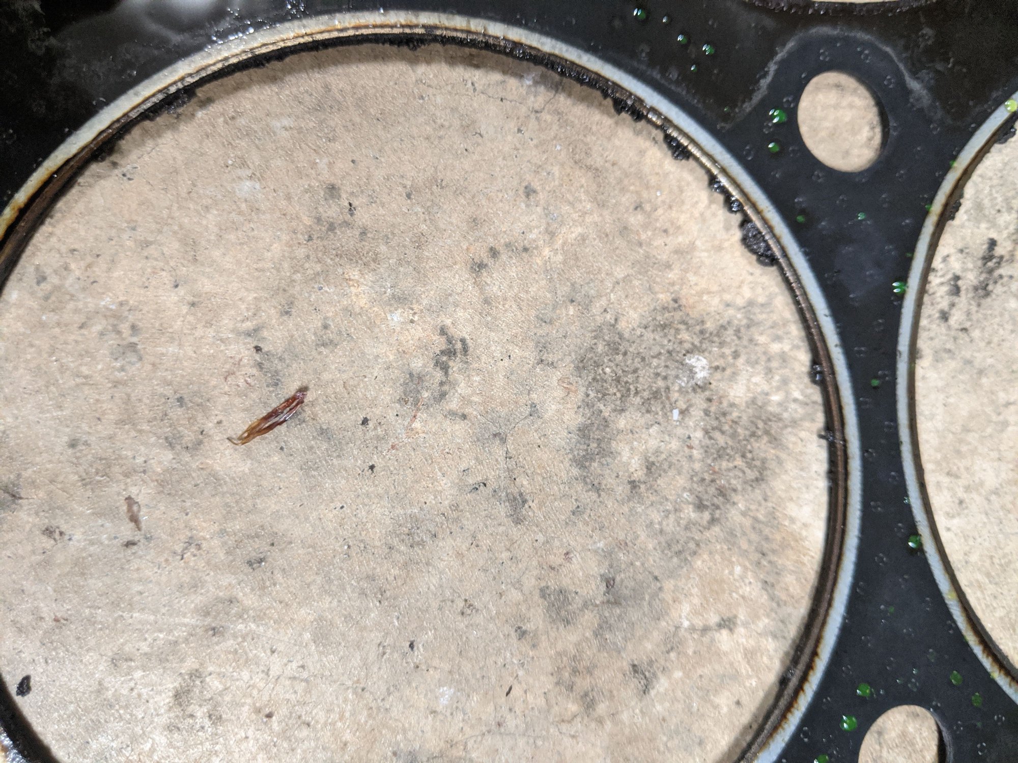

I noticed in one of those gummed up coolant ports there was also a piece of metal (see pic). Can't tell exactly what it was, but it looks suspiciously like it might have been one of those rings from the valve cover gasket which I had done when we first acquired the vehicle. I'm thinking the water pump just moved a notch up the priority list.

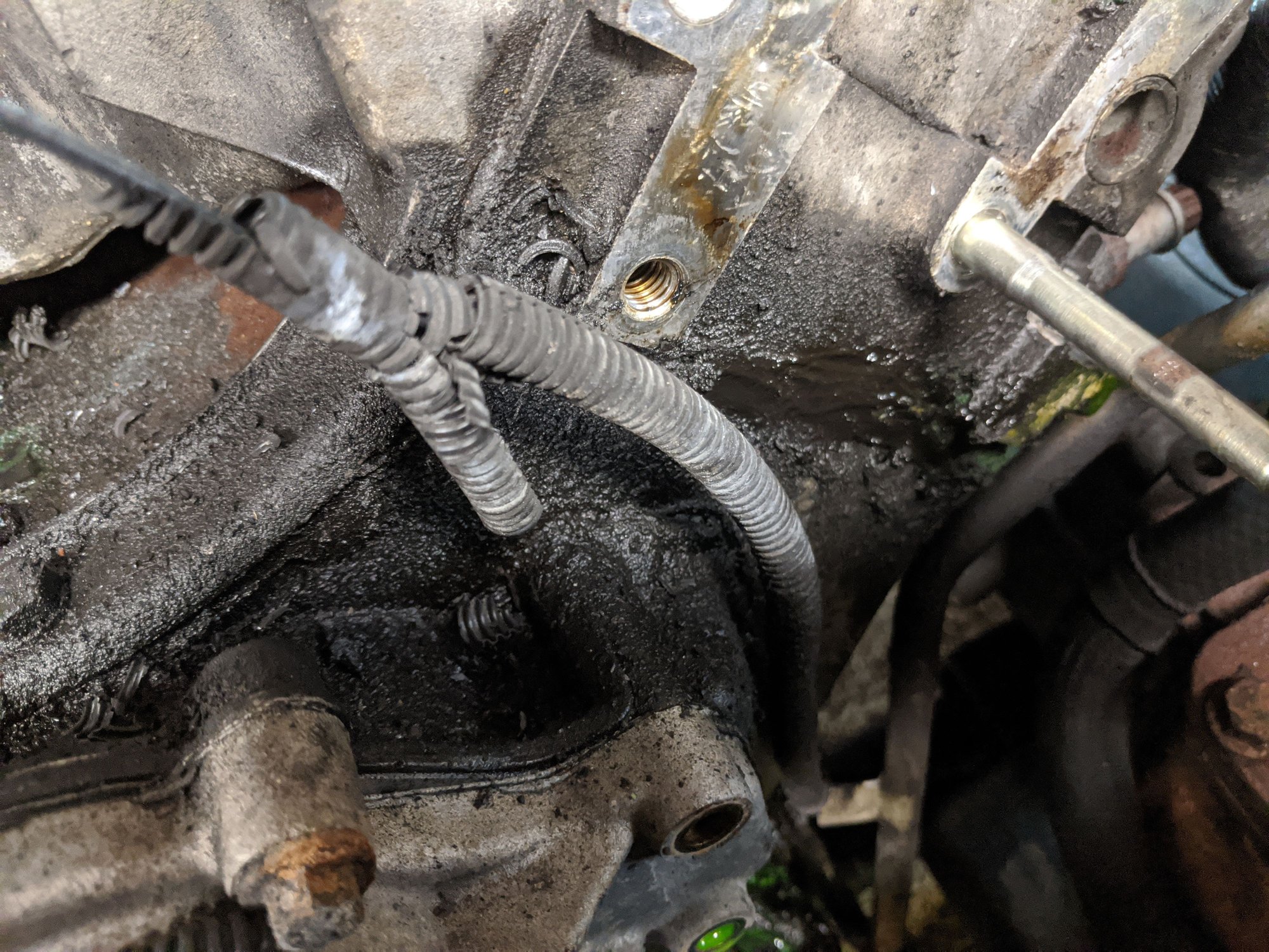

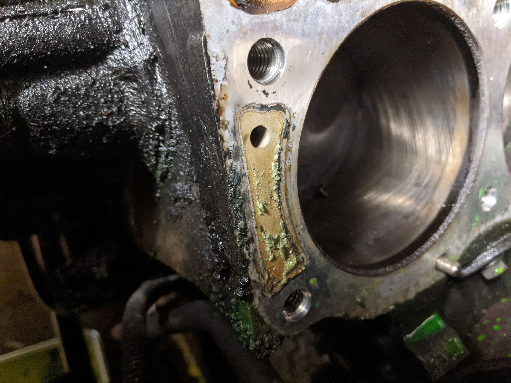

It looks like my multiple leaks were most likely from the coolant ports to the outside of the block? See pics.

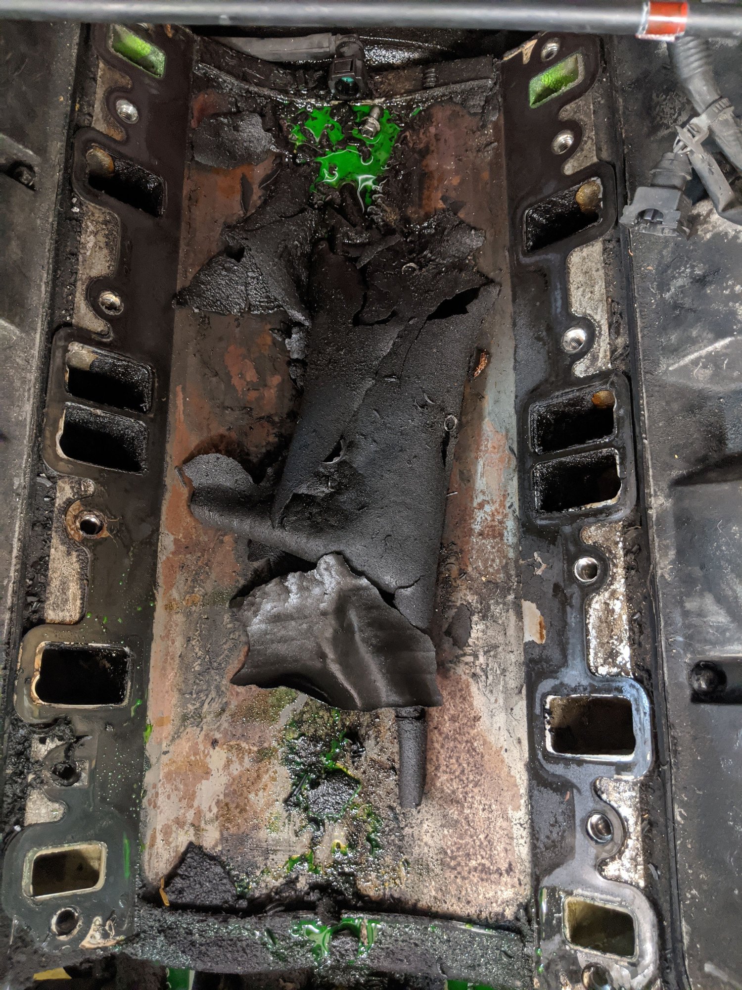

Oh...and both of the oil ports on the back side of the block appear to be completely gummed up.

cleaned the trash out of the coolant port and found metal bits.
Metal bits found in port....possible valve cover ring?
