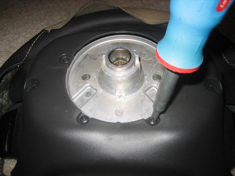

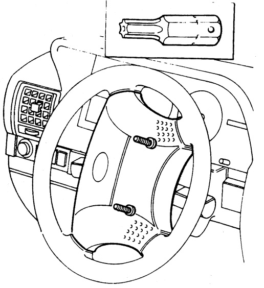

2. Once the battery is disconnected, you will need a long 3/8 inch drive Torx 30 bit. There are two holes, on the back at 3 o’clock and 9 o’clock when the wheel is centered. It is easier to remove these two bolts with the steering wheel turned 90 degrees from level as seen in the first picture
Once the two screws are loose, it is best to manually steer the wheel back to level again as it makes it easier to re-assemble.

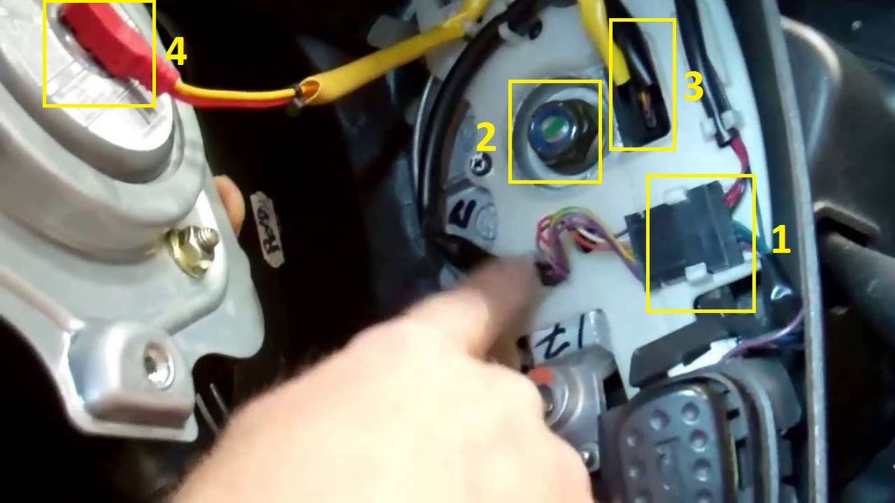

3. Once these two bolts are out, the airbag will be free to come out. Carefully disconnect the airbag plug (it is kind of tight) and make sure to not how the plug is oriented before removing. As seen in box 4 in picture 2. Set the airbag somewhere safe off to the side. The large nut in the center of the wheel holds the steering wheel to the column as seen in box 2 below. Loosen that nut, but do not remove it yet, you are going to be pulling hard on the wheel and leaving it on will keep it from hitting you in the face when the wheel finally loosens. I did a few blows with a rubber mallet and my fist to the back side of the wheel which helped loosen it from the column.
4. There are is a plug that has to be disconnected to remove the wheel completely, it is large a flat and in the upper right area behind the airbag seen in Box 1. Once that is unplugged unclip it from the plastic wheel base and push that plug and the airbag plug through the hole in the back of the wheel (Box 3) as you remove the wheel.

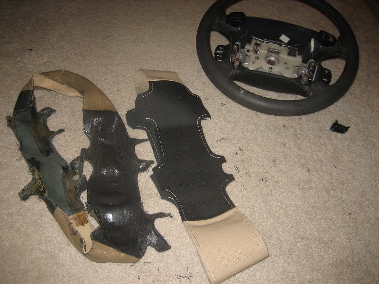

On to the wheel skin replacement:
First off, I like to do things myself, and after hand stitching the entire wheel, it turned out nice, but took me almost 12 hours to do the stitching by hand. Looking back, I probably would have just paid the extra and had the wheel reskinned by the Redline recommended company.

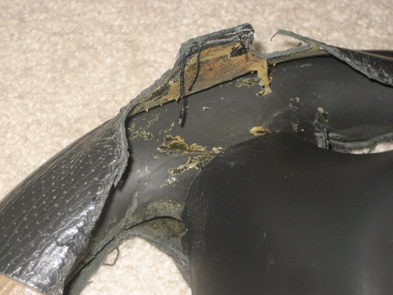

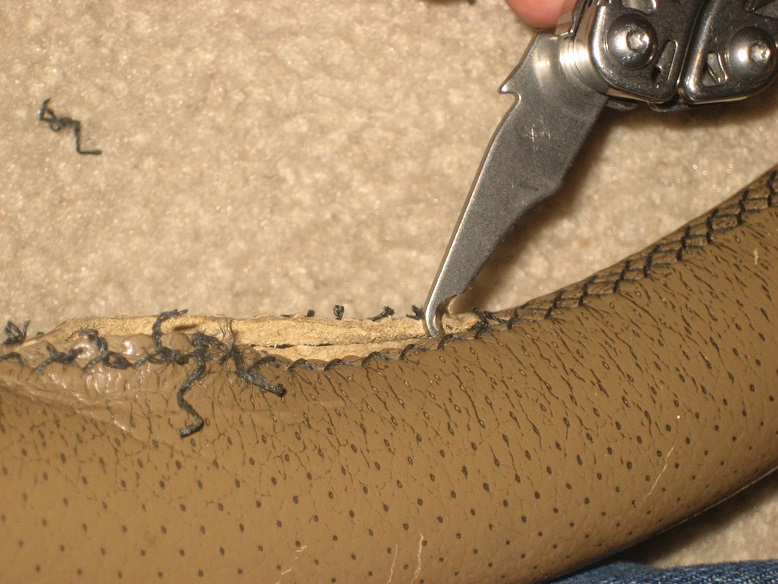

The wheel skin need to be removed, to do this you will need a hook type knife. I was lucky to have one on my Leatherman, on that note, you are not going to be keeping the old leather, so it really does not matter how cut up it gets. I used the knife to cut the stitch which allowed me to peel back the old leather. This can be seen in picture 3.
The leather is glued in place around the spokes on the wheel. It is a rubber cement type glue and it does not really take much more effort to remove the skin where it is glued down. The thing to note is that you will need to get some leather glue to use in these areas when you install the new skin, in picture 4

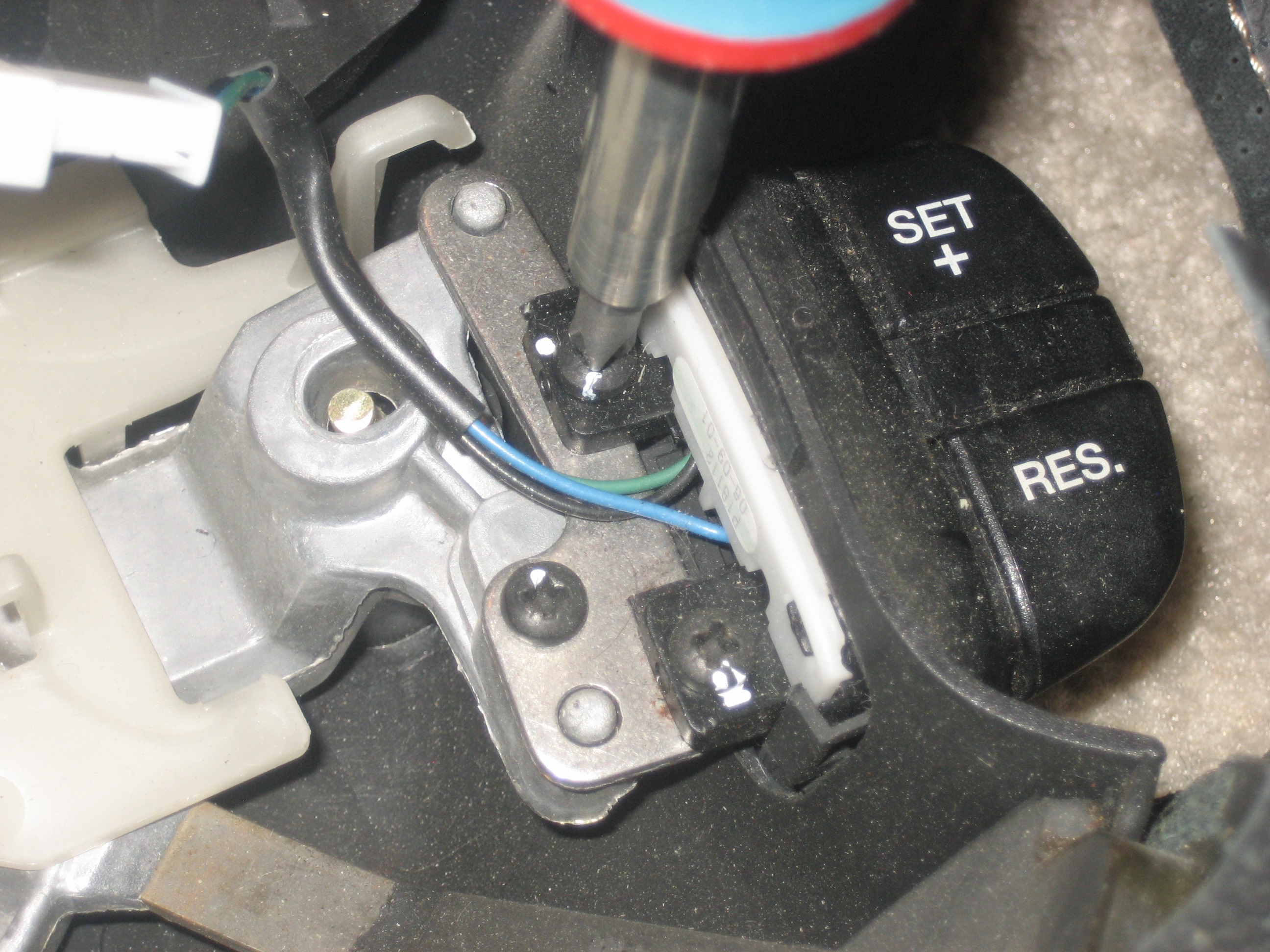

After removing the four screws, you need to remove the cruise control and radio controls from the wheel if yours is so equipped. Doing this requires the same size Phillips screws to be removed. (picture 5 and 6)
Once the switches are unscrewed, unplug them in the wheel, remove them and set them aside. The rear trip piece can now be removed, it takes a little flexing of it to get it over where the cruise and radio buttons were, but it does flex well. Once it is off this is what you have piled up after loose fitting the new wheel skin. (picture 7)

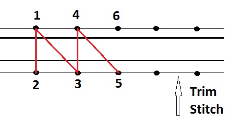

Now on to the stitching, Redline included more than enough string to stitch the pattern I chose, I probably could have done ˝ more, so don’t worry if you have to waste a little string. Also the string is plenty strong, as I pulled it tight after a stitch was made, there was never a thought that the string would break. To start each section I tied a large (quadruple) knot on the end of the string farthest away from the needle and then tied another double knot to hold the string on the needle, once you have done that it is just a matter of stitching. I re-used the holes that the edge sewing used, I have tried to show my pattern in picture 8.
The red lines represent stitches that are on top, here is the pattern instructions:
1. Start from the underside pushing the needle and thread from under hole 1
2. Now with the string through, thread from 1 to 2
3. Now with the thread and needle through 2 and back under the leather, go to hole three under the leather and poke the needle and thread through 3 from the underside
4. Back on the top of the leather go from 3 back to 1 and push the thread and needle through the leather
5. We are now back on the underside of the leather after pushing the needle and thread through, on the underside go from 1 to 4
6. With the needle and thread coming up from the back at position 4, you are now at the repeat position (from a stitching standpoint, location 1 and 4 are the same)

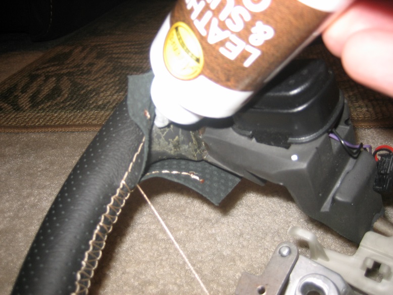

Other patterns could be used, but this worked for me. The spokes of the wheel need glued down (where there was factory glue). I used a product called Suede and Leather Glue made by Aleene’s Original. This glue is a water wash-up and non-toxic. Any glue that comes through the perforation holes can be wiped up with a damp rag. Gluing and stitching pattern are shown in picture 9
You now just work your way around the wheel, this probably took me close to 12 hours to do by hand. Each time you stitch from one side to the other, pull on the string hard to make the leather tight. Also as you work your way around the wheel, make sure that your pattern is straight. Once the stitching is done, you are ready to put the back plate back on. Again, it is held on by 4 Philips screws. It helps to pinch the sides of each spoke cover on the backing piece as there are channels that it goes into below the leather.
