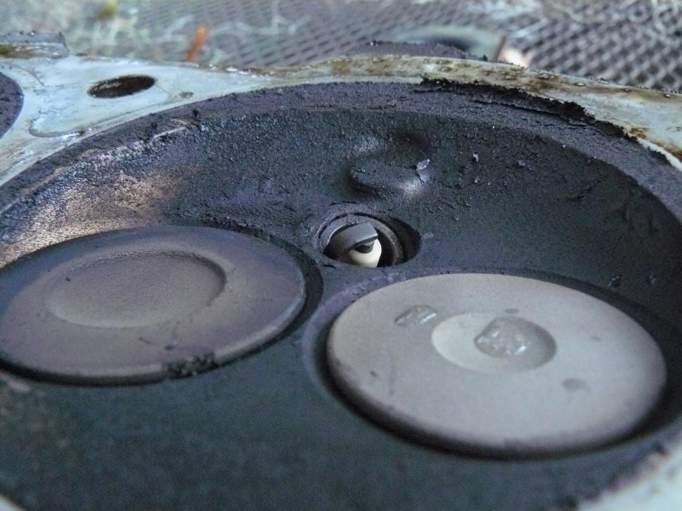

Terms may be misleading. The 4.0 engine, in most of the NAS market, is 9.35 compression ratio, look right above engine serial number. Back when you you could buy "real" gasoline in the 60's, some fortunate Mopar guys had those funny domed head motors with 12:1 ratio. Aftermarket might go to 14:1. A 426 HEMI was a beautiful thing, and no one worried about gas prices.
So while it is higher than some, it is hardly what old guys would consider high performance. High maintenance, yes.
Now I can show you what cheap gas also does, in these pix of a 180K+ engine, I'm sure that most of the life was on regular.
The knock sensors talk to the ECU and it adjusts timing so not so much knocking and pinging,. I think most people won't hurt the engine running regular, they may not get the best mpg. Mountains vs flat lands could be an issue.
