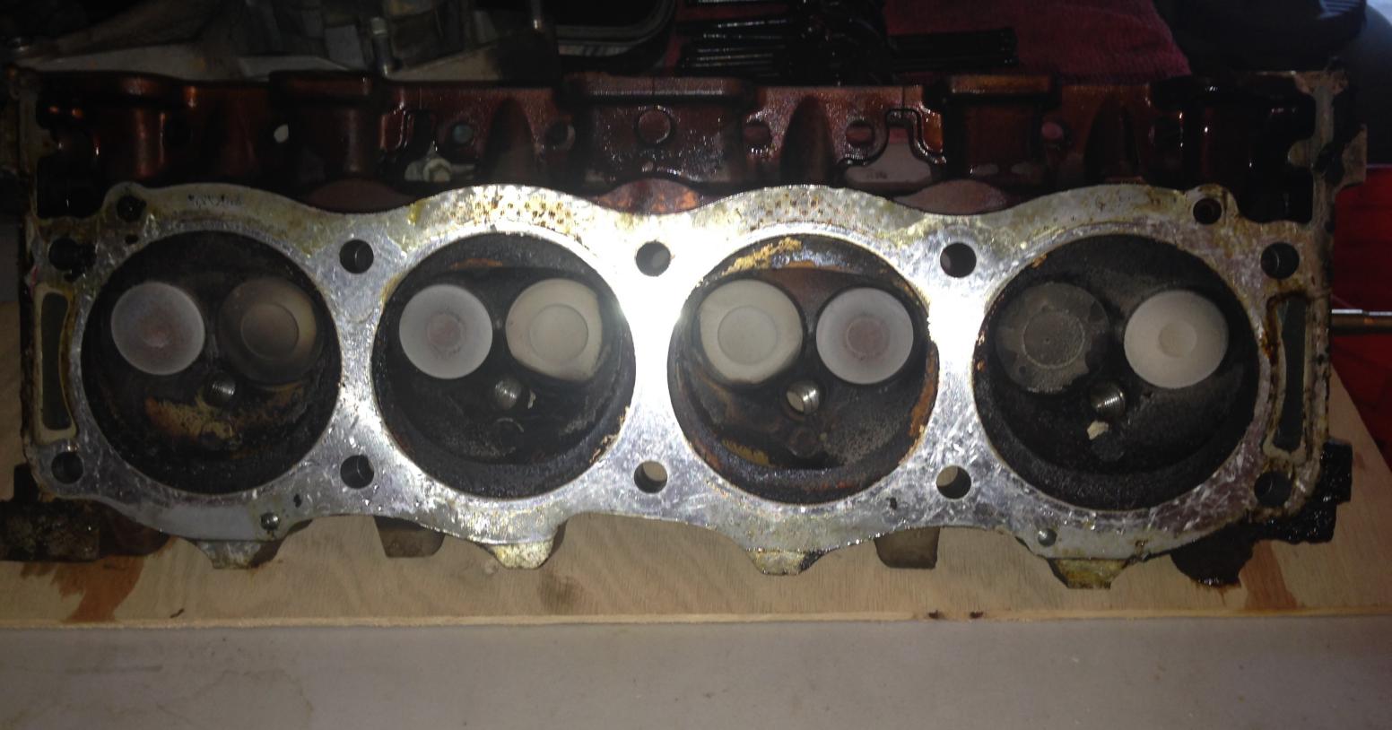

Here are the heads. Looks like more than 80k worth of build up to me. I wonder if previous owners had ever changes the oil. Or if he ran the Odometer back.
I am going to put together a parts list and start placing orders for parts now. I was going to go all out and do the water pump, timing chain, ultra gauge, ect but the more I dig the more I am thinking i'll just fix it and move on. It's got a lot of little annoying problems, not in the best shape, and I keep finding hack mechanic work. I've already spend hours and $$ trying to cure the three amigos to no avail. I'll probably sell it and put the money towards one that is a little newer and in better shape. After having this one for over a year I think I can be a little smarter with the next purchase.
Let me know if you guys think the block looks ok or if its toast.

I don't really see an obvious spot where the gasket was leaking. It had been driven hot several times. It would then run fine for a few days and over heat. I would add coolant and bleed all the air from the system only to be low a few days later. I had it pressure tested twice because I was convinces that there was a coolant leak. After lots of searching here I checked to exhaust for moister and sure enough I had a few drops per minute so I was sure it was from the heads.
I just need to figure out if it is the block or if the gaskets will fix it. I'd hate to put it all back together only to have it display the same symptoms.

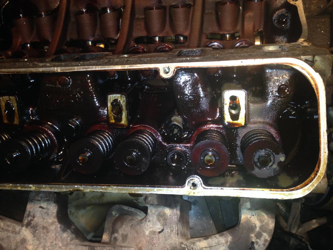

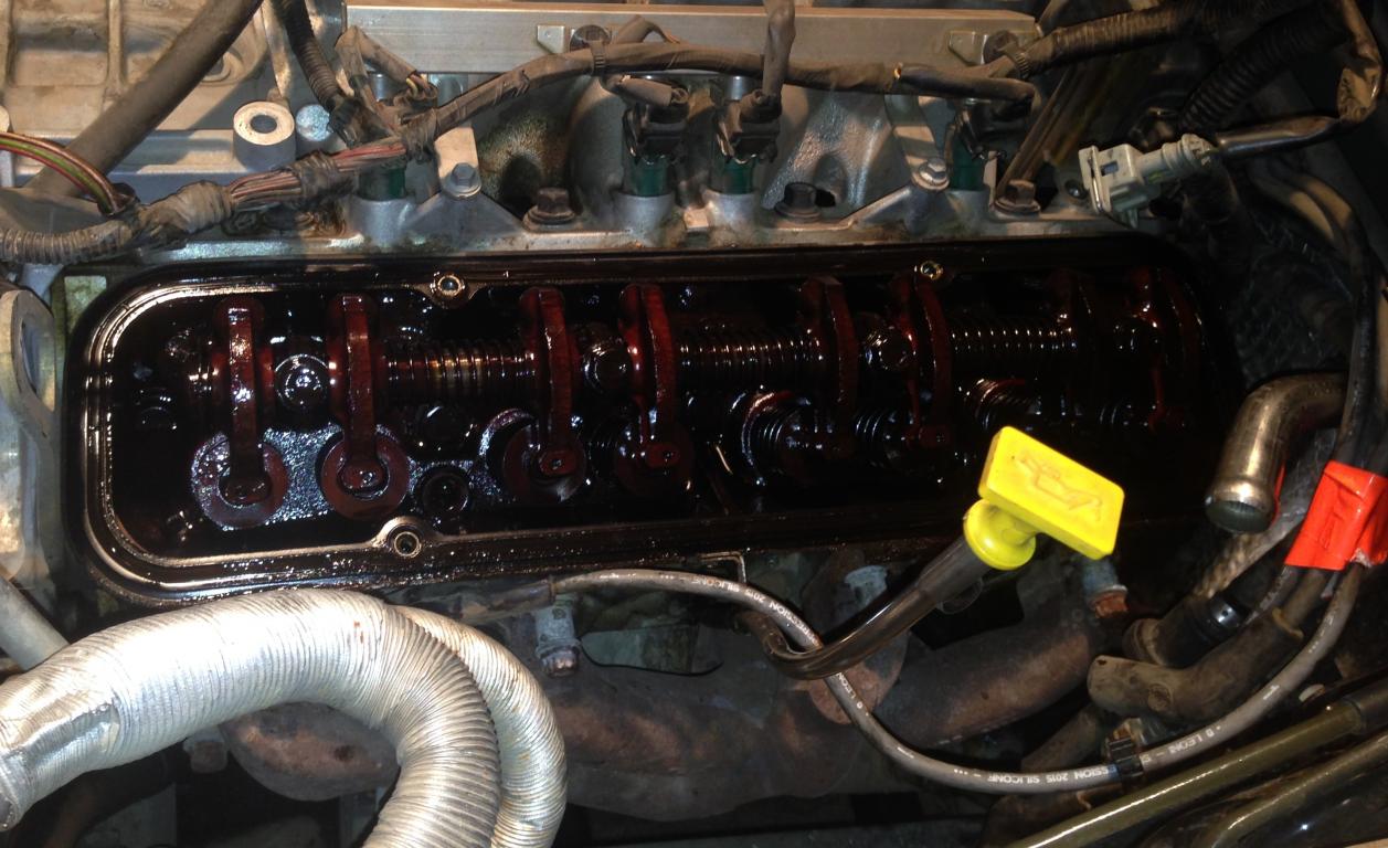

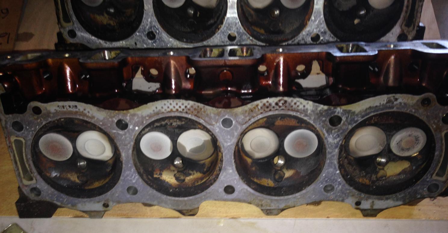

That being said, after the purchase I came across a coolant smell coming from the engine. I took it to a local shop and they quoted me $3200 for head gaskets...ouch! So I started scouring the net looking for answers and found this and a few other great forums.
I began my journey this week to do my head gaskets. I've done an alternator, brakes, a few other items, but nothing like this. So after much help from you guys, a broken lower coolant hose, broken vacuum lines, stripped #3 bolt, 4 broken adapters/swivel sockets and some good music, I finally have the heads off and they are headed to the shop tomorrow.
Thanks again! I'll keep you posted on how it goes.

I dropped off the heads this morning. The shop is a small ma and pops shop in Round Rock called Bishop Automotive. They tested everything while I was there, valve stems, warping.....nothing wrong! Very excited about that, so I chose to have them do the valve job ($175) since the car was at 84,000. Was that a good idea or should I have waited?
I need to do some research on which lines they where. I just know I broke a few brittle ones. As of now the servo line is ok.
I'm supposed to get the heads back Wednesday. In the mean time I will be doing the water pump and cleaning the engine bay. Any thoughts on what I might want to consider?
