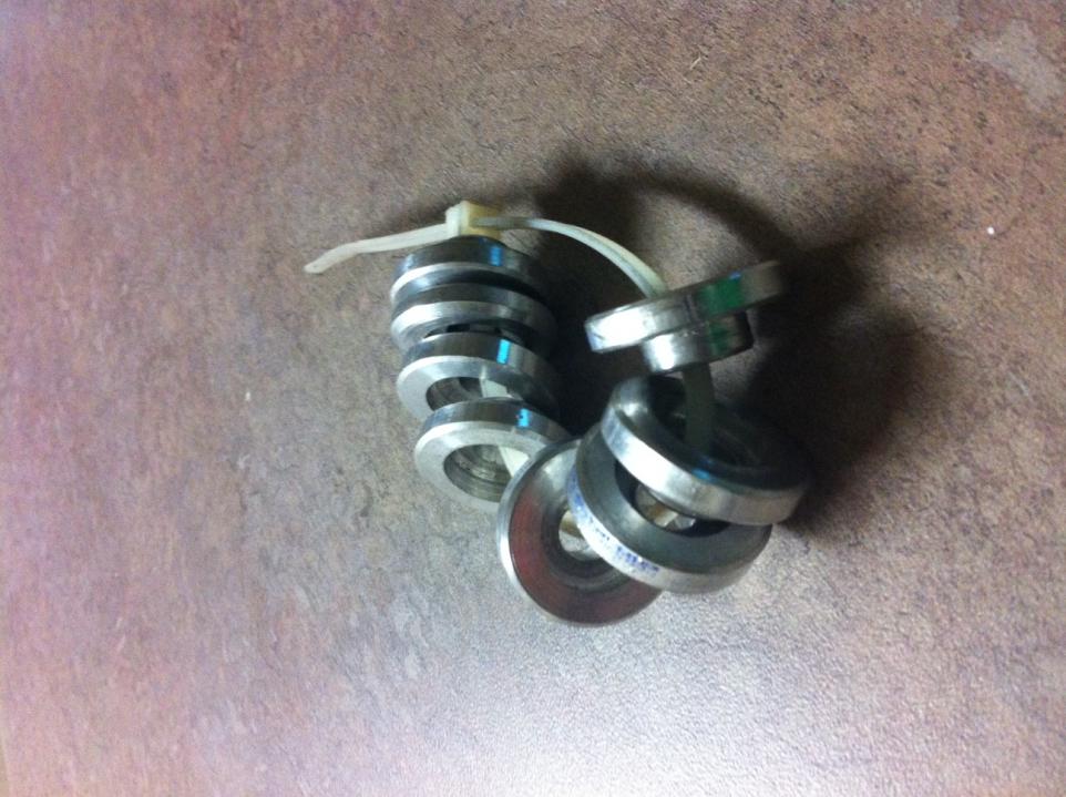

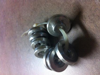

I ended up buying one of the FalconWerks wheels and copied it using a lathe. Pretty easy to do and much less expensive than paying over $200 to replace all the wheels. And I made extras just in case!

How many do you need? I think 8 will do every window regulator.

Talking How many do you need? I think 8 will do every window regulator.
Nope, Discovery IIs have three wheels in each front door, and two in each back side doors, for a total of 10!
