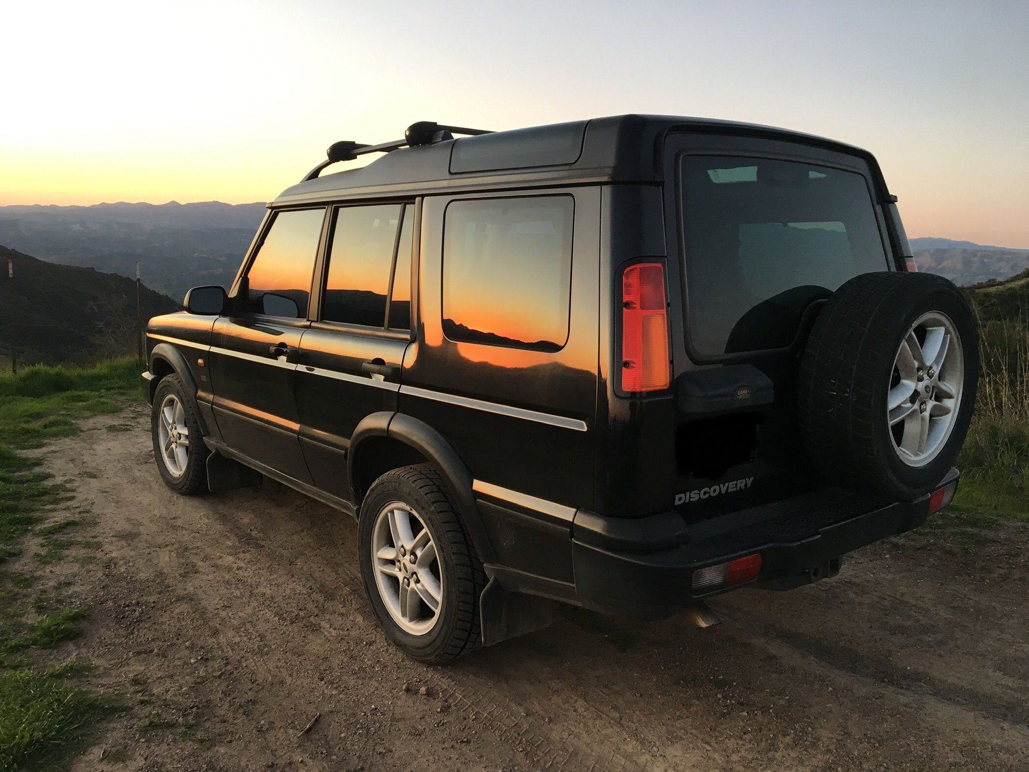

I have the dreaded 2003 Discovery II and it’s giving misfire codes in cylinder number 5, as well as showing low compression (75psi). It also ticks... I live in California in a county where I can’t smog the vehicle for registration completion without getting rid of any engine codes. With low compression, I can’t do that... At least not any way I know of. Anyone have any ideas? Is this engine done for?
The vehicle still drives pretty well, a bit stumbly sometimes, but it makes it up 3000’ of mountain and down regularly.
What’s next? Any advice? Sell it as is / if DMV allows that? There are six counties in CA that don’t require smog certification (including Riverside, San Diego and I believe San Bernardino) - maybe I can sell it there without as much hassle? I was hoping to smog it there, but I‘d expect the DMV would shoot that idea down since I don’t have an address there or anything... Sad times. I like this one a lot. It’s black/black with bad clearcoat failure on the hood and roof, but I’ve fixed a lot of its issues. I also have another Range Rover Classic I need to work on (ABS, or some serious braking issue). Please advise!
Does anyone think it’s worthehile swapping motors? I’d rather not, of course - This vehicle is a daily driver and I’m in need of another vehicle - maybe a 2010-2012 RR HSE or Sport - any words about that? Hope everyone has a better weekend than me! Cheers
