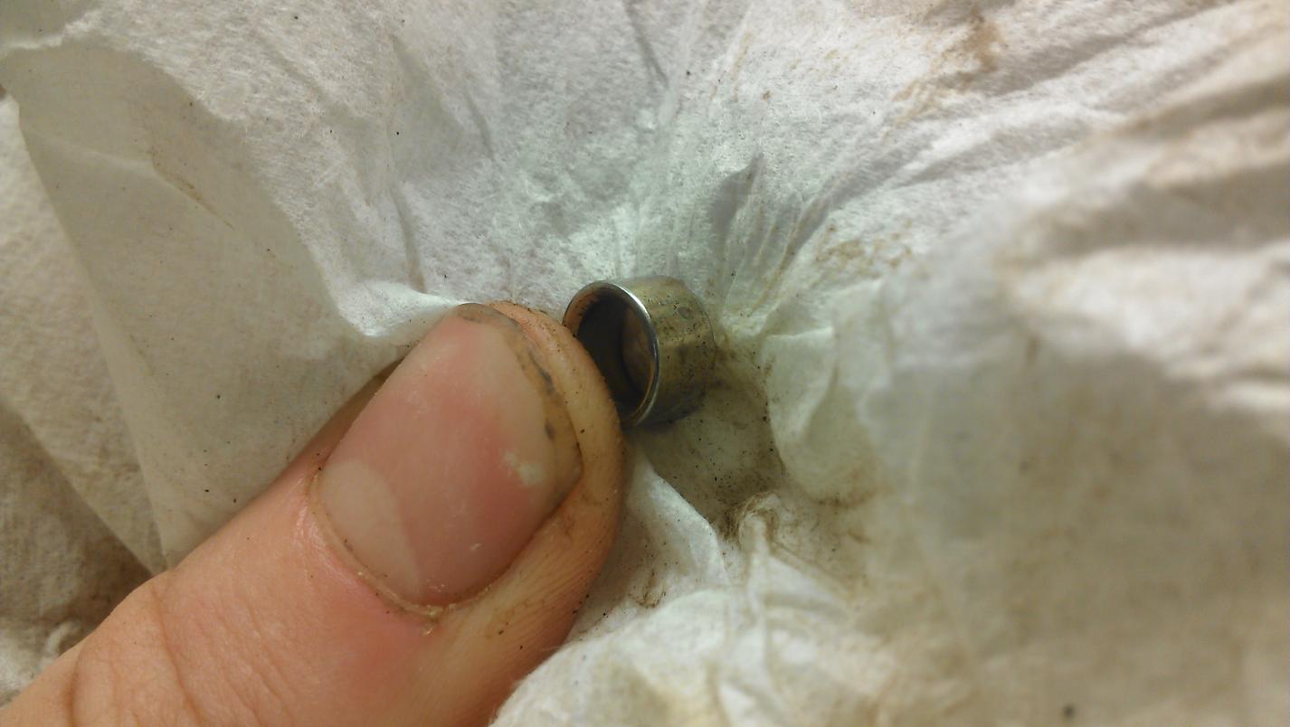

So I am mid headgasket job and I found this little metal ring in the valley after I pulled the right cylinder head. Any idea what it is? If was just laying against a lifter.

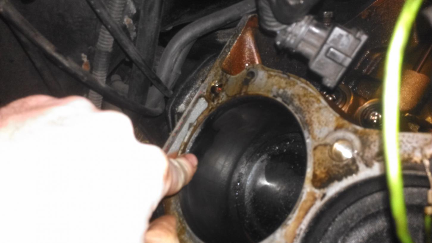

Secondly there is a dark spot on the number seven liner right next to the coolant jacket. Should I be worried?

The ring may well be an insert in the valve cover gasket that keeps you from smashing the gasket when you torque down those 8mm 12 points.
Great call savannah! That's totally what it is.
