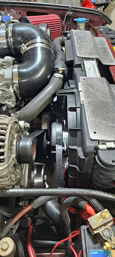

I finally got both my fans and added a universal 12" to fan in place of the condenser fan. It's really cool that I can adjust both fusion fans with the gm pcm independently.
Before when I just had the two fusion fan setup with no condenser fan it was able to survive a very hot and long 20 minute wait on the in n out drive thru with around 97* temp outside with the AC on. It only started to get toasty right at the end. I'm not sure if my breaker tripped or what because it held constant temp for 15 minutes.
I could use a bit better shroud on the top and the condenser fan being installed now should help too. I think this setup can keep a higher compression/ cammed LM7 cool in a Disco 2! How that relates to the rover 4.6 I don't know.

Just a little update on this project...
So I decided to try moving my temp sensor to a new location, just to see how it does, and I'm glad I did. I moved my temp sensor to the inlet of the water pump where there's a nice metal flat spot to mount the sensor on. It works much better than on the radiators rubber hose at the outlet. It senses the temp more accurately, comes on and off quicker, and now keeps my running temps right at the sweet spot where the thermostat stays open so the coolant can flow.
So for anyone doing this mod with the Derale stick on type sensor in the future, who do not have a radiator with aluminum side tanks to mount the temp sensor to, mounting the sensor on the aluminum water pump inlet, works quite well.
