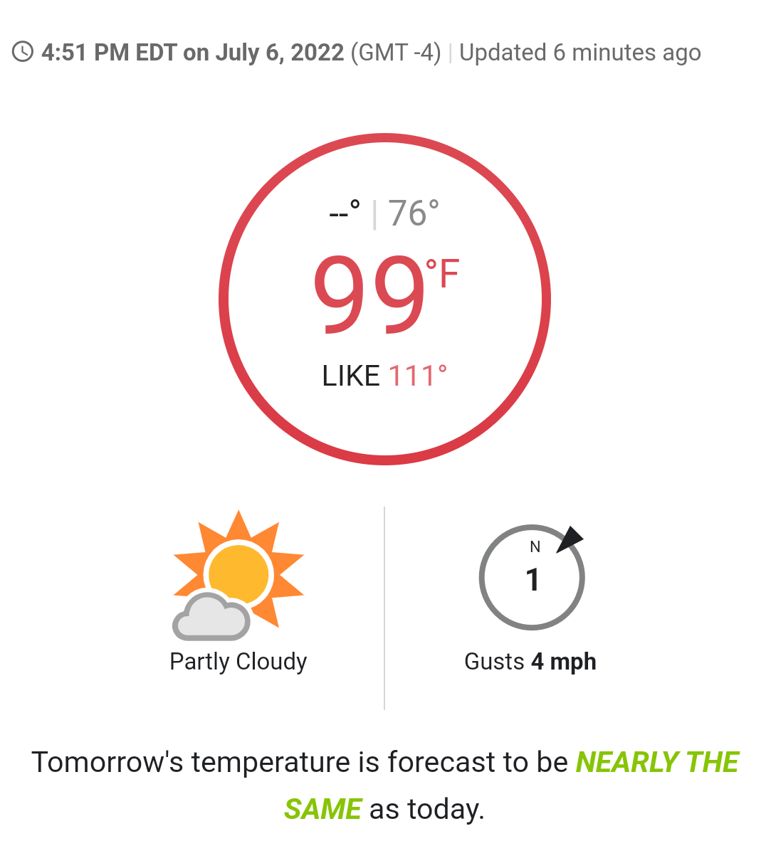

Things got a little warm yesterday, I'm not sure why ​​​​​​
