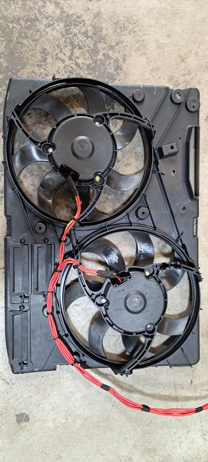

Here's what my fusion fan looked like after some trimming to fit my 5.3 swapped discovery 2. I wired one of the fans to the factory condenser fan wiring (condenser fan was seized). The other fan I'll trigger off the gm pcm most likely. I'm going to make an upper shroud deal this week because using the factory one doesn't look like it's going to be easy with me radiator hose and intake all right there.
We'll see how cooling goes, but with only one fan running it stayed about 195 with the AC on (duh, because that's what triggers the fan at low temps) in 95ish degree weather while idling. The hood was off and the upper shroud wasn't in place.
Oh and the fan setup is super close to the power steering pump on the gm engine setup. I have maybe 1/4-3/8".
