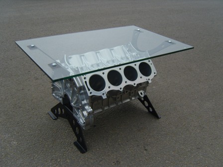

slang, here is a solution you haven't tried yet.... would look good overlooking the beach or in the man cave.
