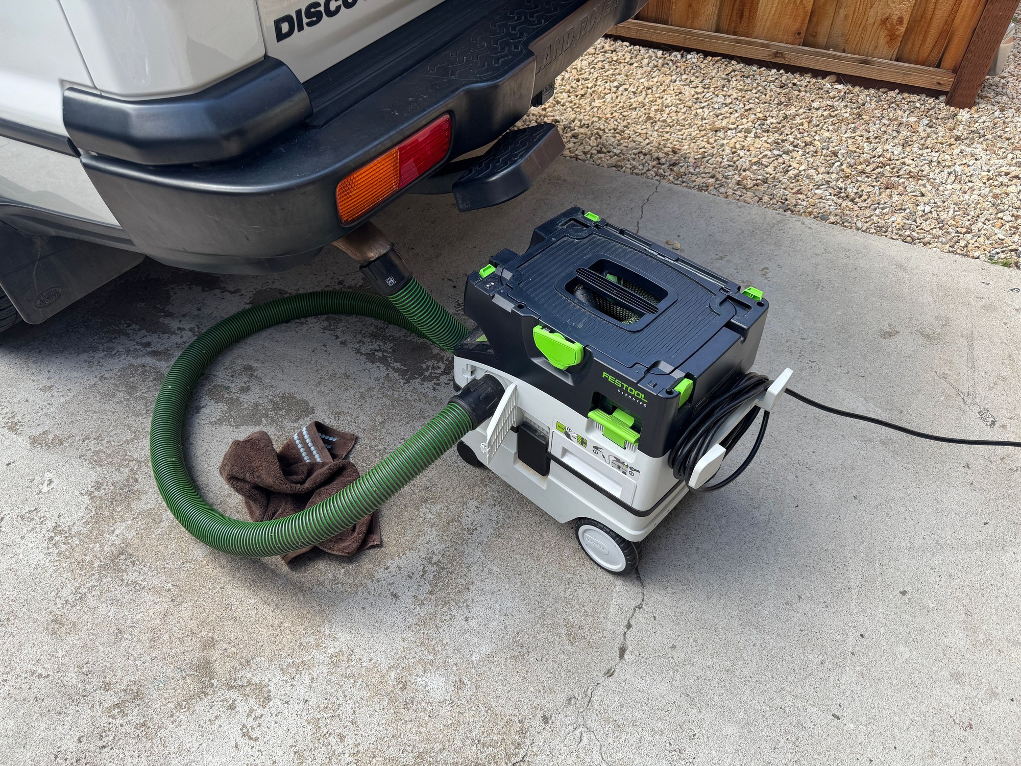

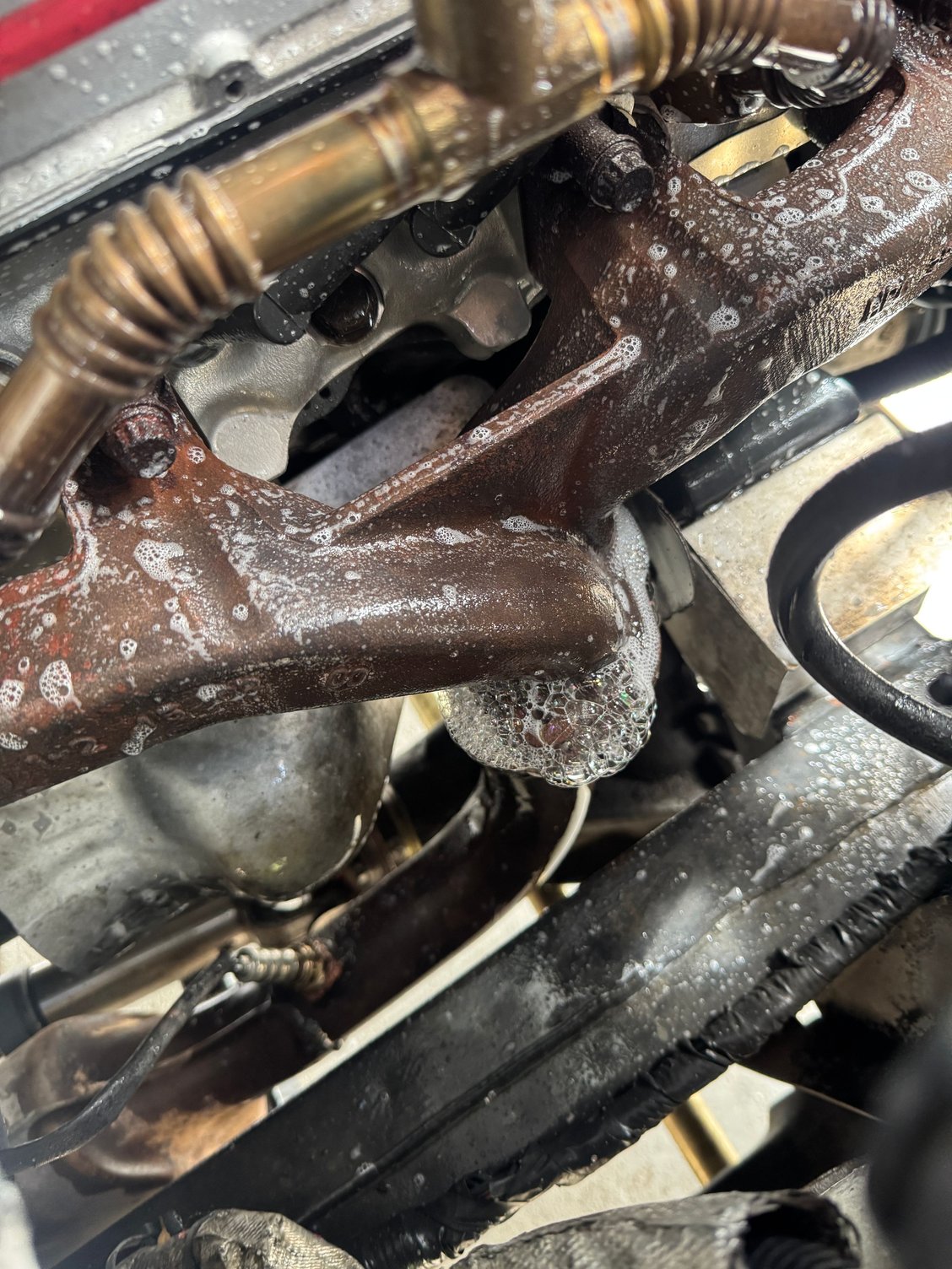

I've never been able to get this manifold/Y-pipe connection air tight (engine stone cold). Should it be or is this just a quirk of discos?

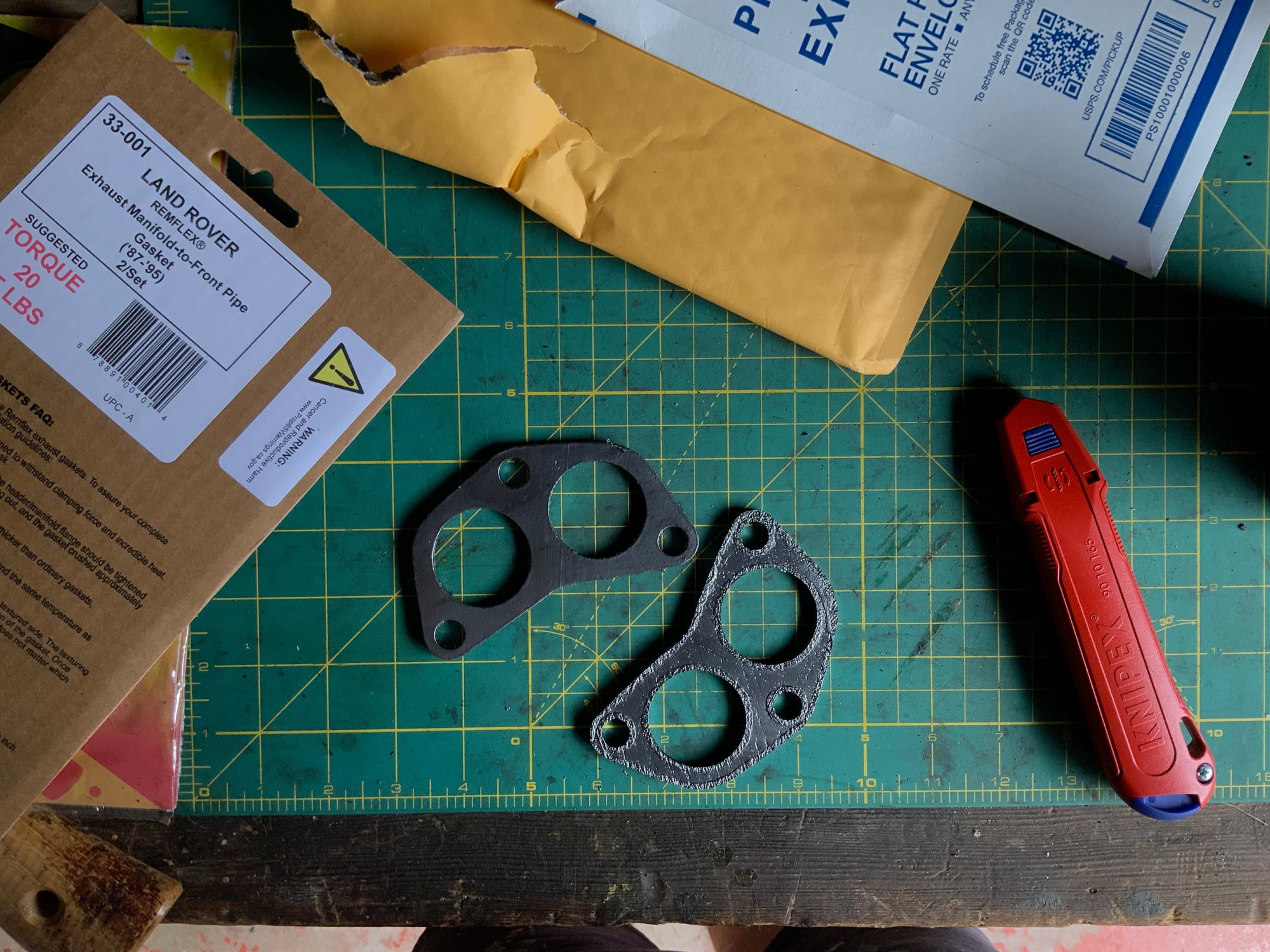

Aw man, I had the opposite experience haha. I put those in and after about a year I was driving home one day and was like... jeez, the Disco sounds like one of those brodozer trucks. Crazy loud. Popped the hood when I got home to find one side completely missing a gasket, and the other was barely holding together. I took off the Y pipe and dumped out a ton of Remflex nuggets that the cats had caught.
I torqued them following the package instructions but who knows. Maybe I got a bad batch ¯\_(ツ)_/¯
