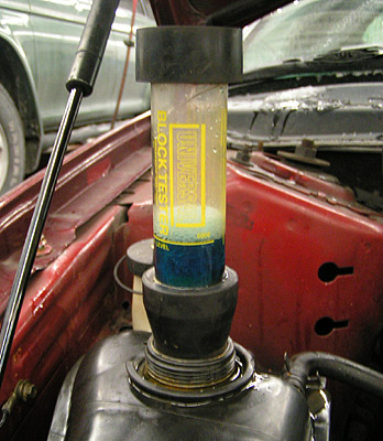

The circulation is normal, in that coolant returns to the tank from the throttle body. But you could have air that needs to be bled out, you could have exhaust gas being generated (a $50 ish chemical test changes color and confirms this), or the coolant cap could be not holding pressure when you are driving. You could zip tie a paper towel around the overflow line to confirm that (would have some coolant loss).

Thanks for the replies guys. I'm going to go out and buy a test kit just to be safe. Savannah, would the hoses get hard if the cap released pressure too quickly? Its just strange that I don't have any symptoms other than these visual ones. Hopefully its nothing. I will get back to you with what I find. I did have a problem with the cap a while back and replaced it so it is not original.

after testing for Co2 you should see if AB or someone has a hose kit for sale and a 180 t-stat.
