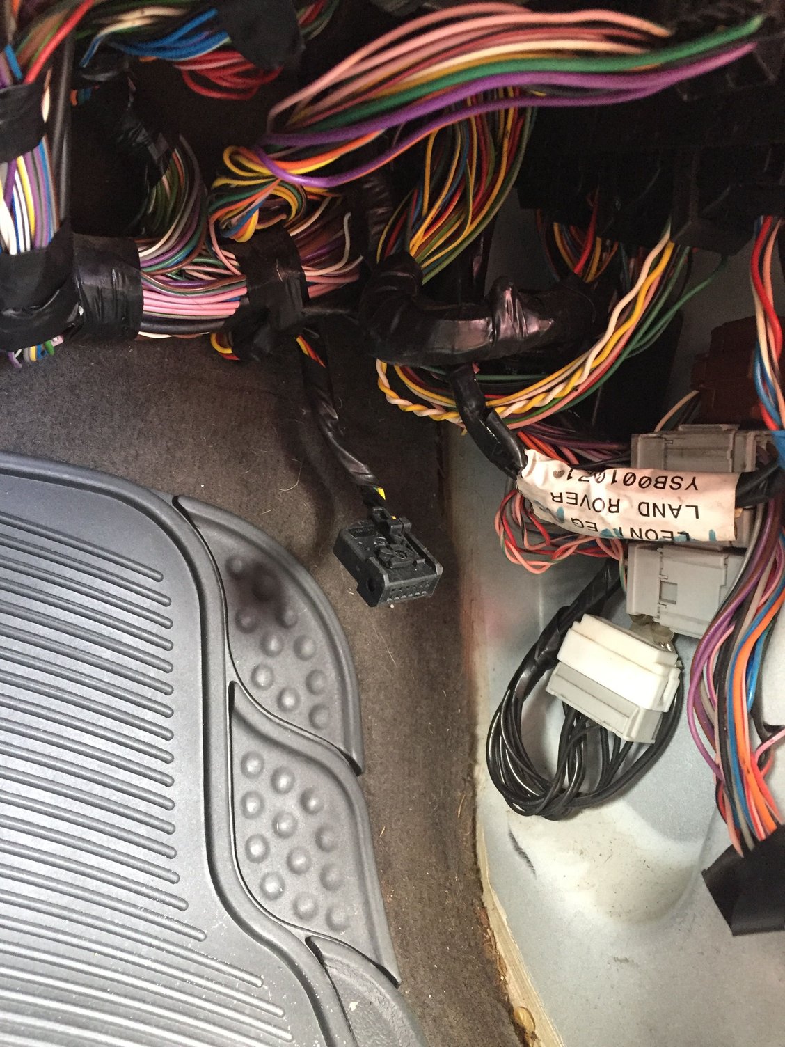

I decided to check all the grounds at the ECM today and noticed this plug that was not connected to anything. Couldn't find any open spots on any of the modules. It's a long shot with all the wiring but does anyone know what this is for?
