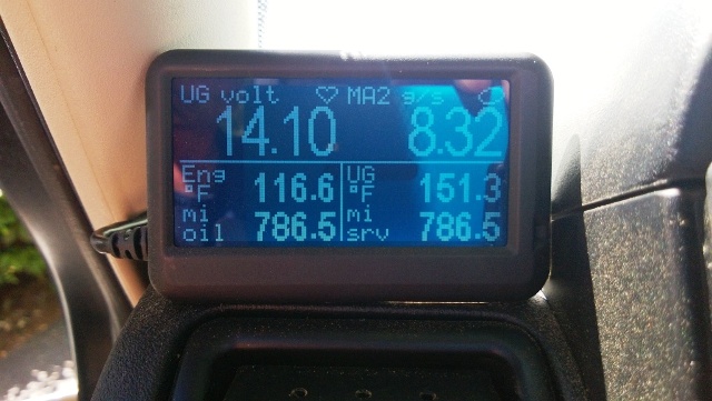

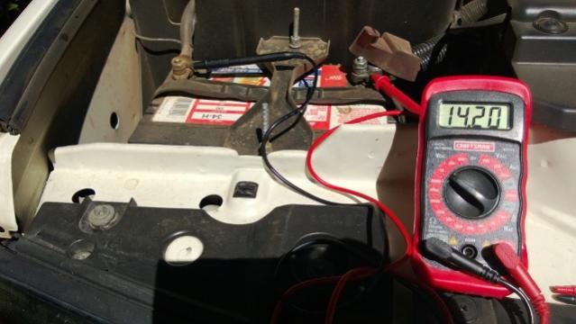

My Original Alternator is putting out 14.38 while charging.

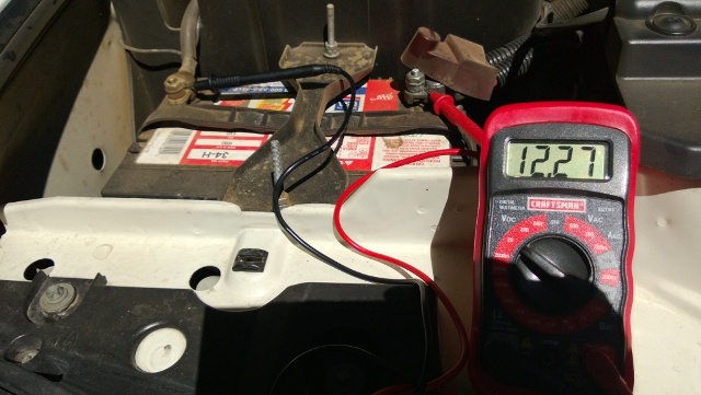

IMHO, a digital meter reading at the battery terminals may produce a slightly higher and "in spec" reading. The Ultra Gauge is plugged into the electrical system, but is not at the point where normal measurements are made. Connections and in particular semiconductor junctions (like polarity protection diodes) drop voltage a little, like 1/2 a volt. So at the battery may well be 14.4.

Very True Savannah. I just checked again, on both the UG and the Battery.
Key On, Engine Off
Key On, Engine Running
Attached Thumbnails Fixed my low voltage-ko-eo-ug.jpg   Fixed my low voltage-ko-eo-batt.jpg   Fixed my low voltage-ko-er-ug.jpg   Fixed my low voltage-ko-er-batt.jpg

and the age old question comes in as to which is more accurate. You can put six meters on a bench, and have six different readings.
