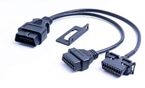

My Discovery II 2002 has an OBD2 that won't sit in the trim harness anymore. Instead of rewiring a new OBD2 port, what do you think of adding an extender and plugging that into the trim?
If I did wire a new port, what is the cheapest way to get a replacement? All OBD2s are the same I think.
Photo:The OBD below has an extra port for a SAT. 12 bucks on Amazon
Thanks,
Sean

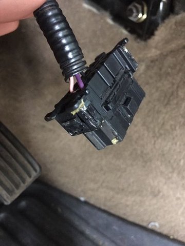

Mine got the back pieces snapped off.

No reason the extender would not work, it is just an access port

I put a sheet metal screw on either side. Just between the trim panel and the OBD port, into the space between them. Works like a charm, rock solid.

Thank you for the replies. I got the cord today from Amazon, 11 bucks. The new port snaps in nicely. I tied the GPS wire to the main cord, and plugged the main part to existing port. Transmits perfectly.
